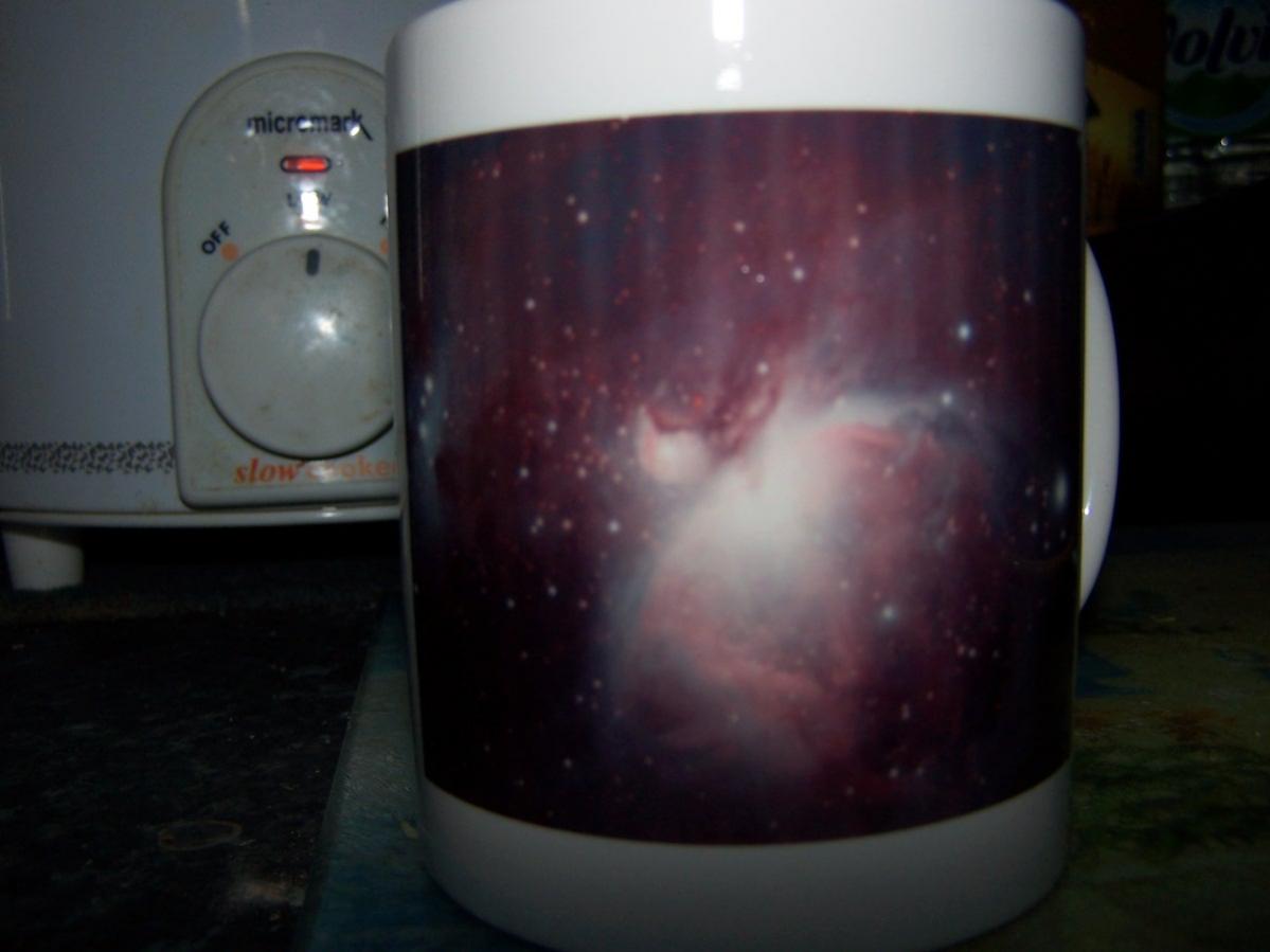

I have the right ink and it is working okay now. Setting printer to best photo quality and photo paper (can't find epsom vivid on mine), have the press at 180 for 120 seconds, but although the image comes out, in places there are stripes instead of full clear colour. Could this mean more time, more heat or should I change to one of the epsom glossy settings?
