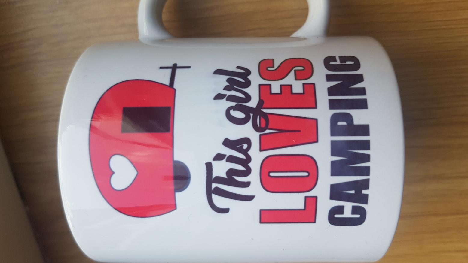

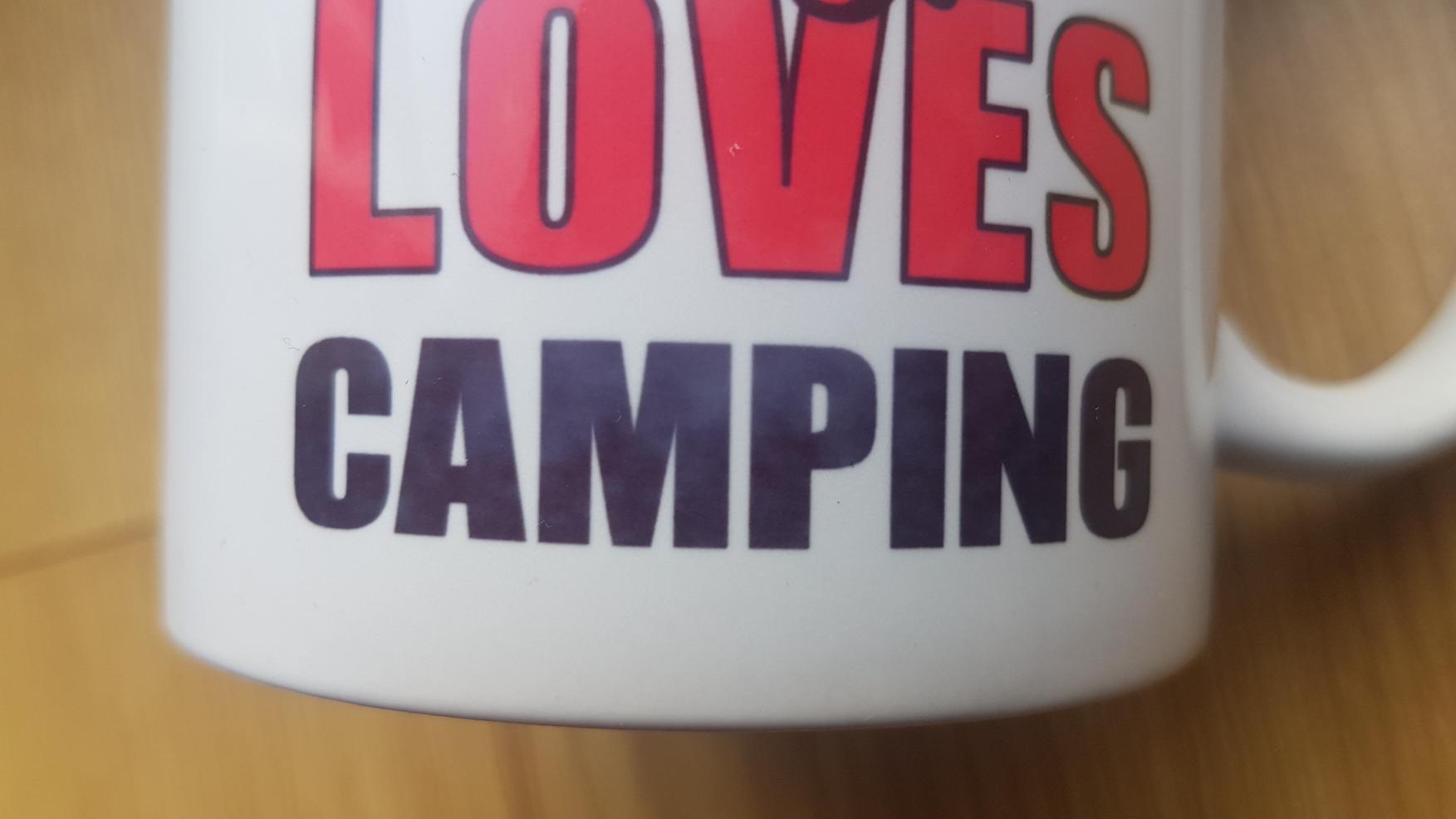

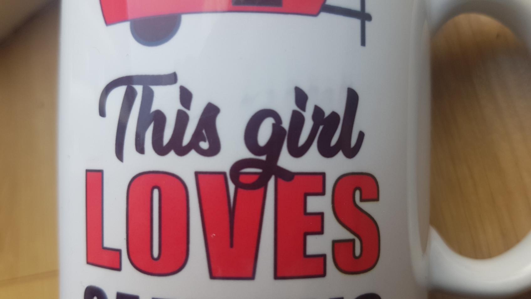

Just done another test for the wife, and not very good results once again, colour was supposed to be a hot pink and came out red, the 'this girl' text has a ghost double image above it and the black camping looks very faded.
Need more heat or time or both ? 180c at 10 mins.

Re: Halogen oven hit & miss results
I'd say try less time (8 or 9 minutes).
I doubt whether pressing times or temps will improve your colours though. Are you using the recommended ICC profile when printing?

webtrekker;139198 wrote:I'd say try less time (8 or 9 minutes).
Oh Ok would less time, take away the fading of the black? Yes im using a recommended ICC for my inks, supplied by Ink Experts.
Maybe its the mugs then giving hit & miss results.
