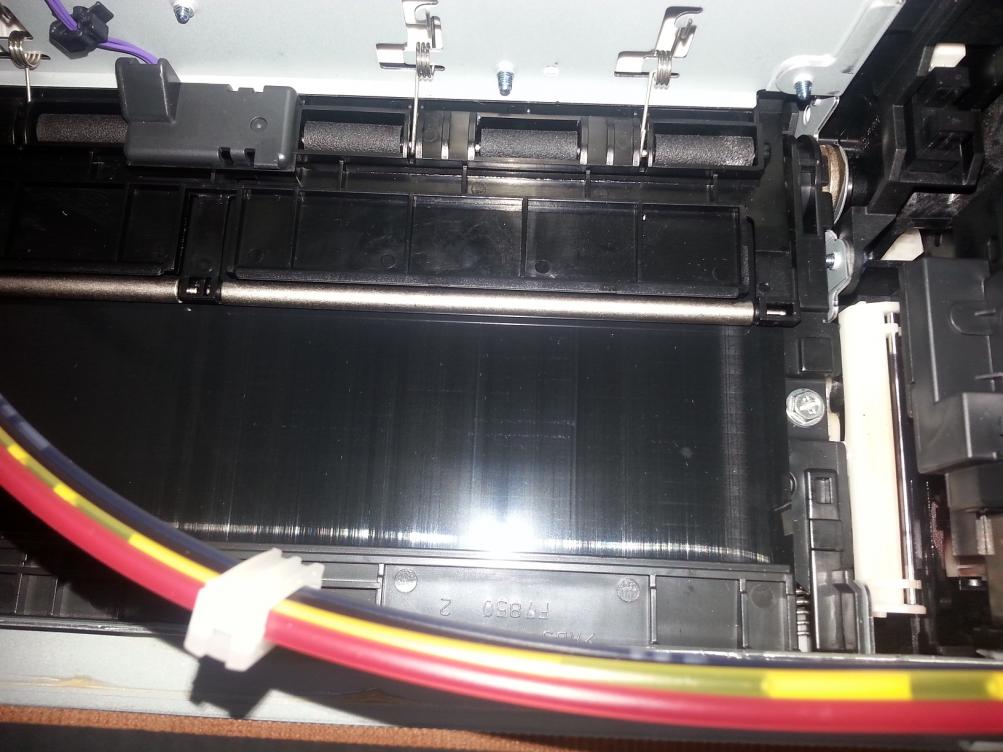

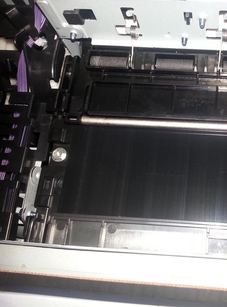

I bought a printer through someone on the forum about a month back, because the seller said it was in perfect working condition (it cost £90). Yet it has banding issues that I haven't been able to fix, I've tried everything!
Yesterday I lifted the hood off the printer so that I could peer inside, and I spotted these lines (just like the banding that ends up on the prints) running all across a piece of plastic film. Photos attached:
Is this normal? It looks as if the lines are part of the plastic (etched or bumped onto it) rather than ink accumulation.
All replies are appreciated!

Have a read of this thread in case it helps:
http://www.dyesubforum.co.uk/vbforum/sh ... d-dithered

Thanks, I'll give this a try!UK Printed Mugs;117400 wrote:Have a read of this thread in case it helps:

Re: Photographs of inside of my RICOH SG3110DN - is this normal??
my belt has lines and works fine
Is it normal for the Ricoh ink lines to have those air bubbles in them?
I have no idea?! But the worst of the bands are always in one place. I've done a head clean, nozzle check, alignment, head position.webtrekker;117403 wrote:Is it normal for the Ricoh ink lines to have those air bubbles in them?
I only ask because air bubbles were the reason I removed the CISS system from my Canon inkjet printer. I've never looked inside my Ricoh's though to see if mine are the same.
Did air bubbles cause you banding problems?webtrekker;117406 wrote:I only ask because air bubbles were the reason I removed the CISS system from my Canon inkjet printer. I've never looked inside my Ricoh's though to see if mine are the same.
They certainly did, but I don't know whether the Ricoh's are any different to a normal CISS system.
Maybe purging your Ricoh would remove the air bubbles and improve the performance banding-wise, but it does take a toll on your ink levels.
