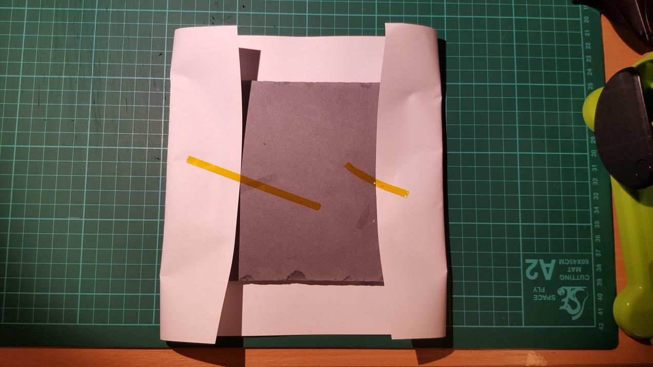

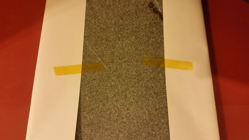

Re: Slates
Post by wayupnorth »
No need to put the tape anywhere near the image:
vB_ID:3788
vB_ID:3788
vB_ID:3788
vB_ID:3788
vB_ID:3787
vB_ID:3787

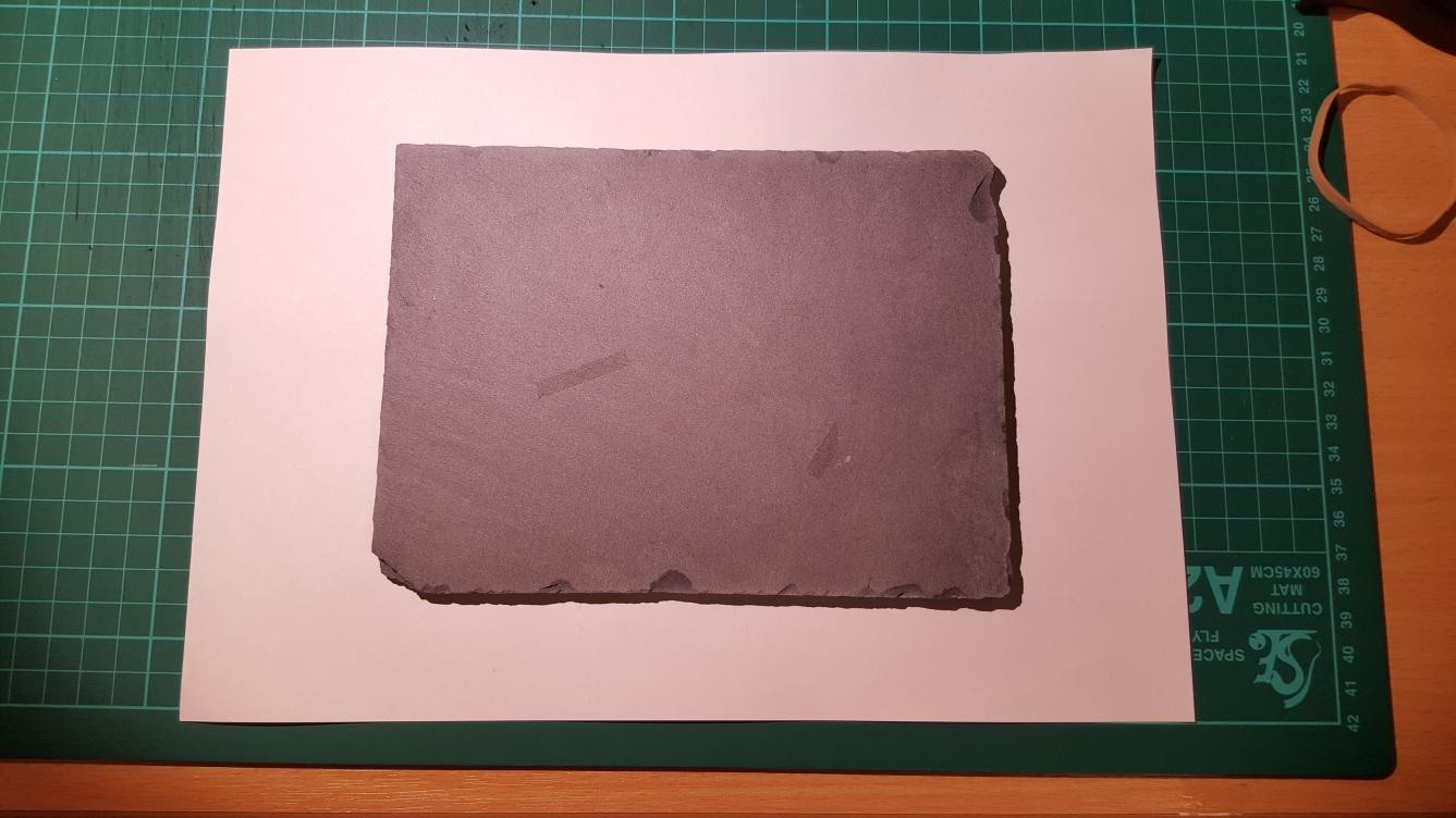

scotty44
Posts: 218
Joined: 11 May 2014, 23:59
Re: Slates
Post by scotty44 »
Why do you need to put tape onto the image:confused:
I have just done a few so took a picture of mine!
vB_ID:3789
vB_ID:3789
2015-12-20 17.58.48.jpg (97 KiB) Viewed 238 times
