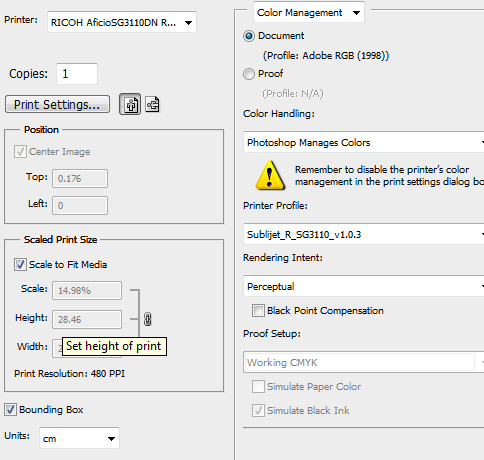

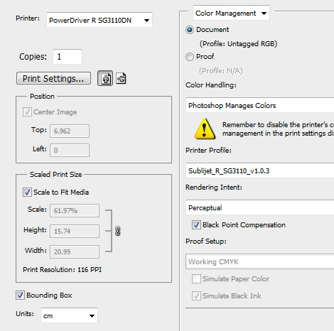

Should the profile be set to Picture 1 (turned off) or 2 ?
- vB_ID:3367
- power2.jpg (90.61 KiB) Viewed 276 times
- vB_ID:3366
- power1.jpg (87.93 KiB) Viewed 276 times
Re: Profile setting in P/S ?
both are wrong!

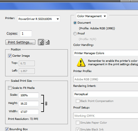

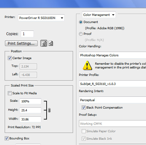

Use photoshop manages colours with the ICC profile when printing with the Ricoh driver (make sure any colour management or enhancements are then turned off in the print driver options)
or
Use printer manages colours when printing to power driver
document profile should be Adobe 1998
or
Would these look better, if I get what you say mate this should look right :rolleyes:
