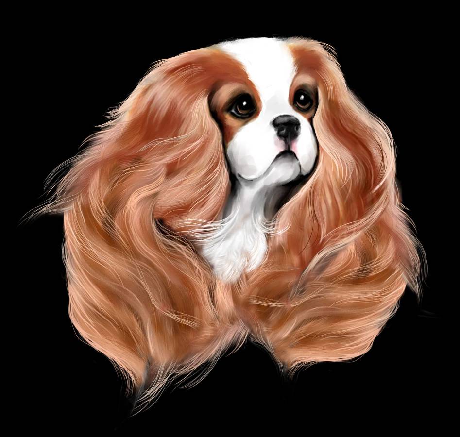

1. This is the original picture, notice the brown part of the dog is a chestnut colour. When printed on a normal printer it is almost perfect. When I print onto the sublimation paper, it is slightly orange. Once the image is processed onto the coaster it turns into a bright orange. I have just looked at the mugs I produced earlier in the week and they are also orange. I set the temperature for 200, initially 60 seconds but the image looked scuffed, so I increased to 70 seconds, everything looked perfect except the chestnut colour is orange.
This is the originial.
[ATTACH=CONFIG]1487[/ATTACH]

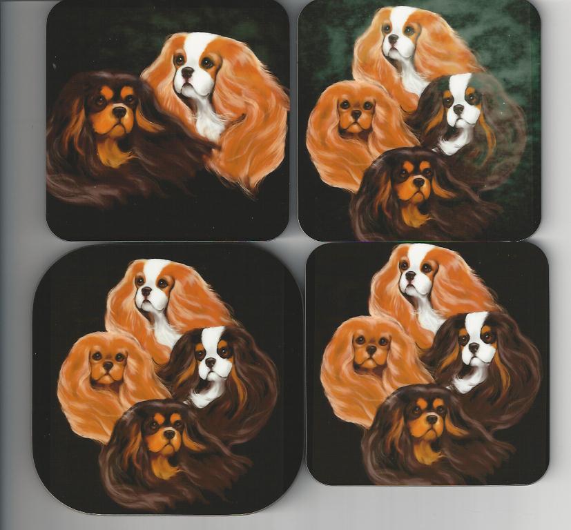

This is a selction of four I produced, the ears have turned orange.
[ATTACH=CONFIG]1489[/ATTACH]

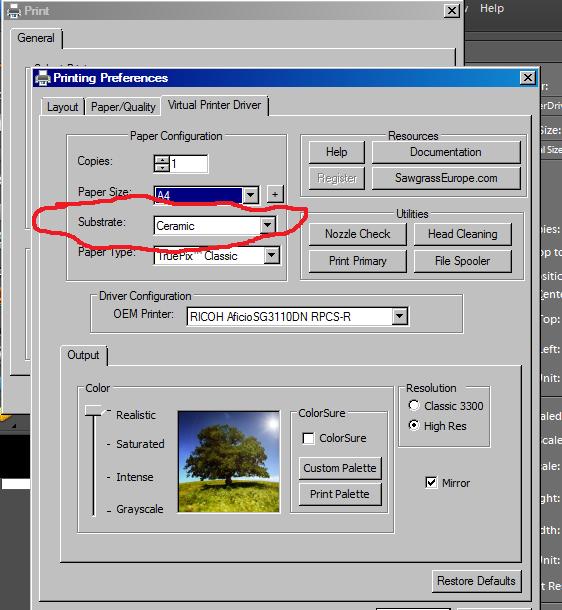

[ATTACH=CONFIG]1490[/ATTACH]
Have you changed the sublimation product to unisub or whatever the coasters are in the powerdriver?
The top right hand one looks like moisture, did you pre press them?

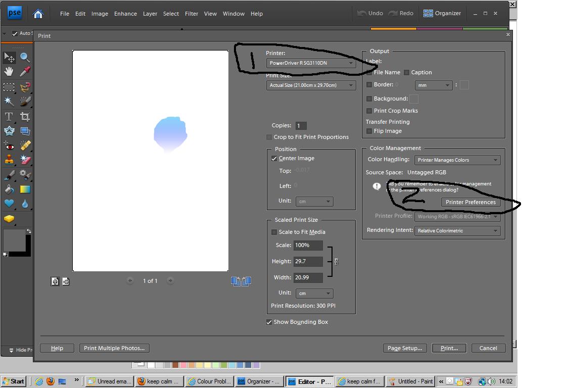

[ATTACH=CONFIG]1492[/ATTACH]That is the powerdriver.
When you go to print do you see on the list of printers power driver
1 choose printer
2 click on here show the other screen
