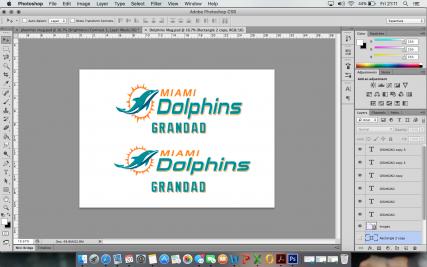

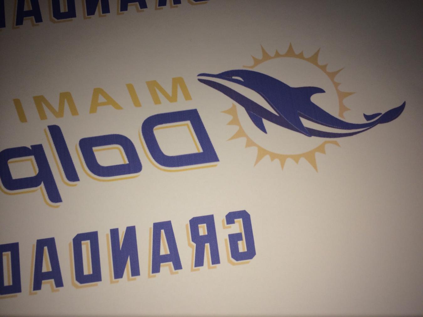

Above is what it looks like
Below is what it should look like! having a fight this evening ti get it to print the cyan!

I played around with some settings and pressed it to see how it came out.
Although the paper appeared poor coloured and wrong it actually transferred off ok!
