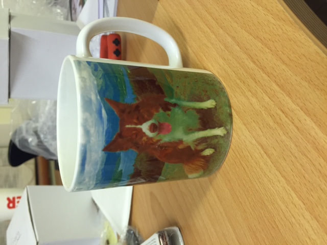

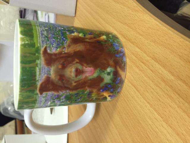

Re: Banging my head against a brick wall
Thanks for the replies. I did try at 180 degrees for 180 seconds but it didn't improve the result.
Here are the original images and the finished mugs.
Hmmm! See what you mean.
Have you printed any test images prior to this using your current setup? Something with basic colours?
I use a series of colour and tone wedges containing RGBCMYK and Black 10%, 20%, 30% etc together with industry standard reference images. It provides a more objective approach to how the colours reproduce.
The other thing I have noticed is that suppliers/manufacturers often seem to give different (reduced) time and temp recommendations for the Ricoh printers. I'm not sure that would apply here - depending on your ink.
might be your 'good quality sublimation ink' - even with a profile, is it the right one for your printer?
look at very fine detail on image and then mug (hair round eye etc) - is it 'soft' on the mug - maybe sign of over cooking as is blacks going brown.
We mug at about 160c for 90secs
