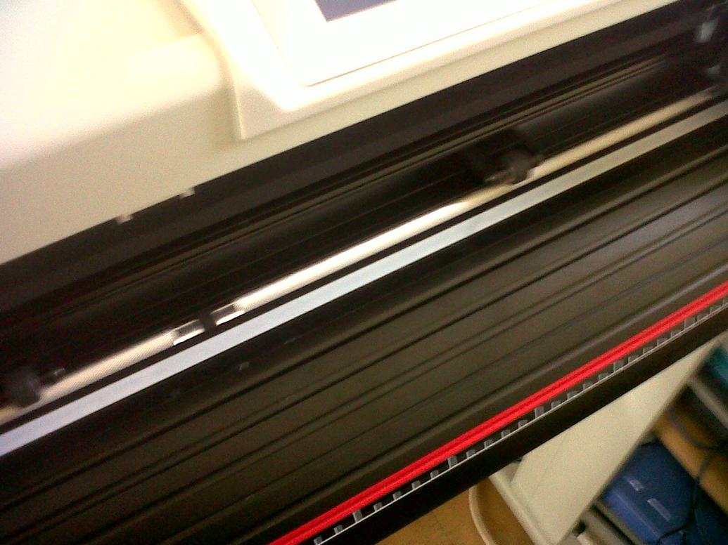

So i am new to all this malarky and having nothing but trouble! Bought this machine from signzworld but it seems to be broken! Plugged it in and the motor holding the cutter was off the rail, so sure it wouldnt work. Fastened it onto the top runner and the bottom runner and now its aligned all the way right and sounds horrid!! Like its going to combust! Have i just put it back on the runner wrong? Help!!! please lol x

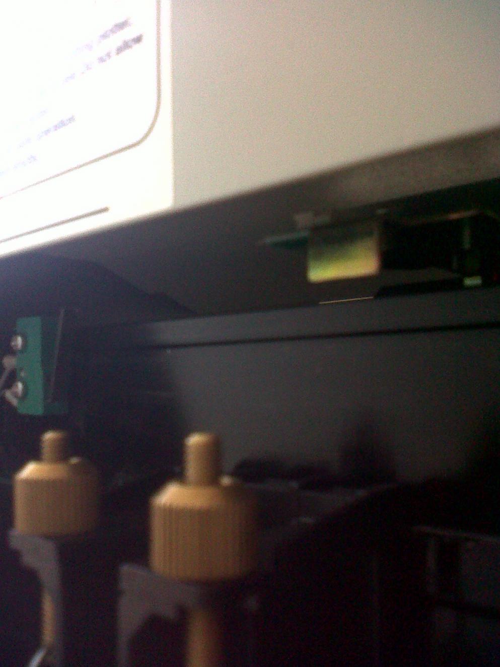

I have fixed it, the bracket at the back wasnt connecting to the cut off leaver to tell the machine to stop trying to go further right... * woman, dont expect tecnical terms*. So!!! one issue solved * well 2! spent too long trying to find the drivers to get it going as well* now i cant get it to recognise i am sending a job thus still nothing but a test square cut :'(.

A picture is worth a 1000 words?
Hope this will help anyone who has the same issue.
[ATTACH=CONFIG]2942[/ATTACH]
