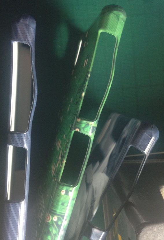

Any of you who are printing 3D Phone covers had any luck printing the Sony Xperia case?
See the photograph for the problem I am having. I have tried all sorts of methods - reducing time, temp, dunking, not dunking, molding back into place with my hands etc etc but nothing is working.
If you have had success with this cover please share your time and temp so at least I have a starting point.

Are you cooling them on a dummy phone? Haven't done one of these myself but know some of the others have had similar issues. It is a very delicate design with the heat required. The similar problems we encountered we kept on a dummy phone and dunked whilst we knew it was held straight.

Tried cooling on the phone and dunking, no joy. Tried moulding the thin strap back into place as well but that didn't work. Its as if it has stretched which is obviously a bit of a pain. Have contacted Subli Blanks so they might be able to shed some light.

Be interested to hear if you do find a solution as I cannot see an easy way around this. Certain versions of the Samsungs had this bar removed and left open (the matt option I think). Not sure if you have choices on the Xperia for blanks.

Subli Blanks are suggesting to let them air cool so will give that a go first.
