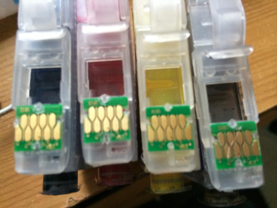

no, my chips have 4 at the top and 5 at the bottom.
I've tried my cartridges in another printer and the same problem is happening there, so it must be to do with the chips. Is there a way to reset these without a chip resetter?

- vB_ID:2884
- image.jpg (88.27 KiB) Viewed 269 times
