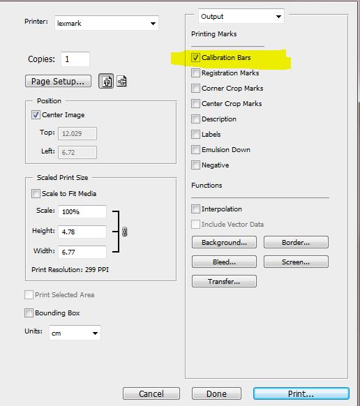

I think you can do that by choosing options (where Color management is) on the print screen and checking the calibration bars box.

Hmm,
What version of PS do you have - I'm on CC and have all of those options except the calibration bars!

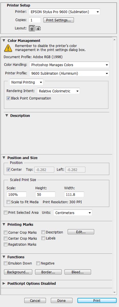

Ah, don't some Googling and the calibration bars option is in the PostScript section, which is not selectable with the printer I'm using

This is all I have...

Hi Pisquee,
I have CS4.
It looks like I was lucky in choosing the printer. Following your reply, I found that it is greyed out for some of my printers. According to PS online the calibration bars are only available for postscript printers.
I have CS4.

could you not just manually place/draw 4 coloured rectangles at the edge of a file, and either use that as a template or place it in each file as you are printing? Would be a little slower, but should only take a few seconds.

Spongerobinson is on the right track.
Draw up a set of boxes and fill them with cmyk, rgb, greyscale or whatever floats your boat.
Open a new action and allocate it to F2 or another convenient F key
Record an action to
paste the colour patch into an area of the page that would nomally be empty
Flatten image
Then all you do is hit F? Everytime you start a new image or just before you print
