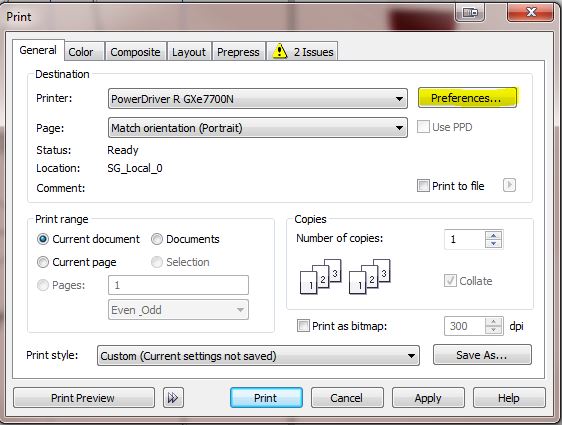

The easiest way to print a palette is to go to the print screen in CD, use Powerdriver as the printer & choose preferences:
[ATTACH=CONFIG]2720[/ATTACH]

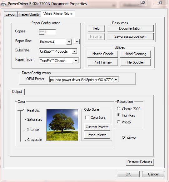

Here choose the substrate you'll be using & the paper you're printing on, then click "print palette" & follow instructions:
[ATTACH=CONFIG]2719[/ATTACH]
To see the finished colours you will need to sublimate the resulting printout onto whatever item you are going to print.
