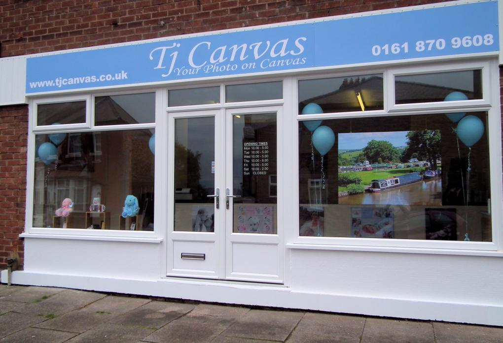

Alot of printers use it for external signage, our shop sign is printed 5mm Foamex and still looks as good today as the day it was put up however you've got me worried now
[ATTACH=CONFIG]2717[/ATTACH]
- vB_ID:2717
- shop14.jpg (93.21 KiB) Viewed 11 times
