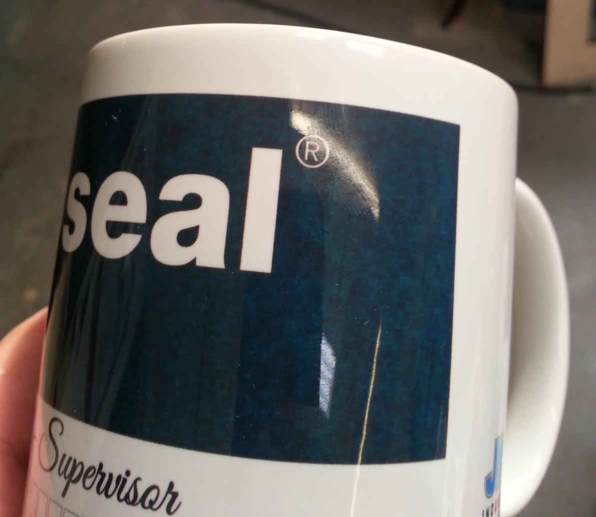

I seem to have got the other colours spot on, but the black is giving me a headache.
Completely new to sub printing.
Have a doodles 5in 1 press,
the black is coming out with a marble effect.
Upped the temp to 200c ( or in f as this one is ) 3.5 mins
got a slightly better black but not shiny, dull and flat.
Any advice would be great, Cheers

The press you have is almost neither here nor there, as long as the temperature read out is accurate. Without knowing what your ink is, what your paper is, what the coating is on your mugs and if you have an ICC profile for those inks running through the printer you could be going through a lot of trial and error and a lot of wasted mugs.

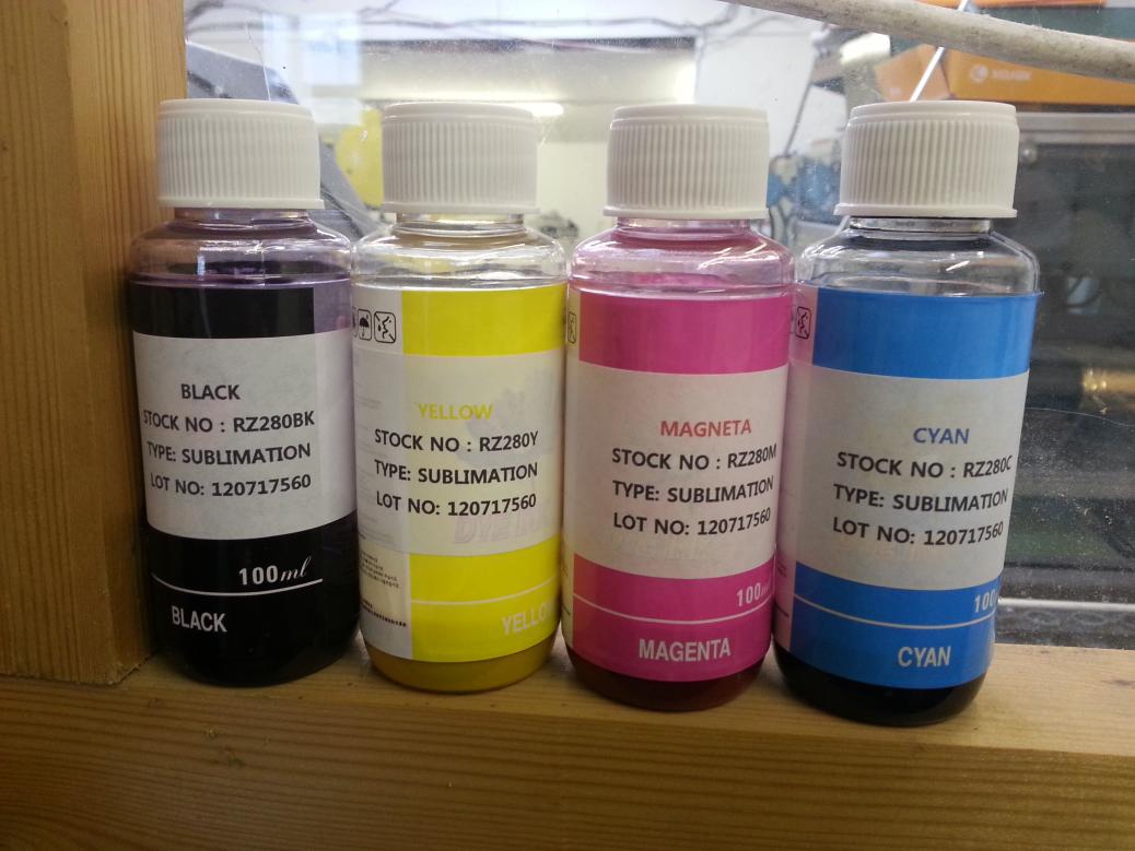

ok here goes
Ink [ATTACH=CONFIG]2643[/ATTACH]

and No icc profile, running an Epson XP-212 with the continuous ink

Looking at the photos, I would be questioning the transfer paper you're using.

OK, no idea on the ink - unbranded, so could be anything - could be amazing quality or complete crap, but you'll never know without an ICC profile to go with it - if whoever sold you them can't supply one, then you'll need to get one made - talk to Paul (moderator on here)

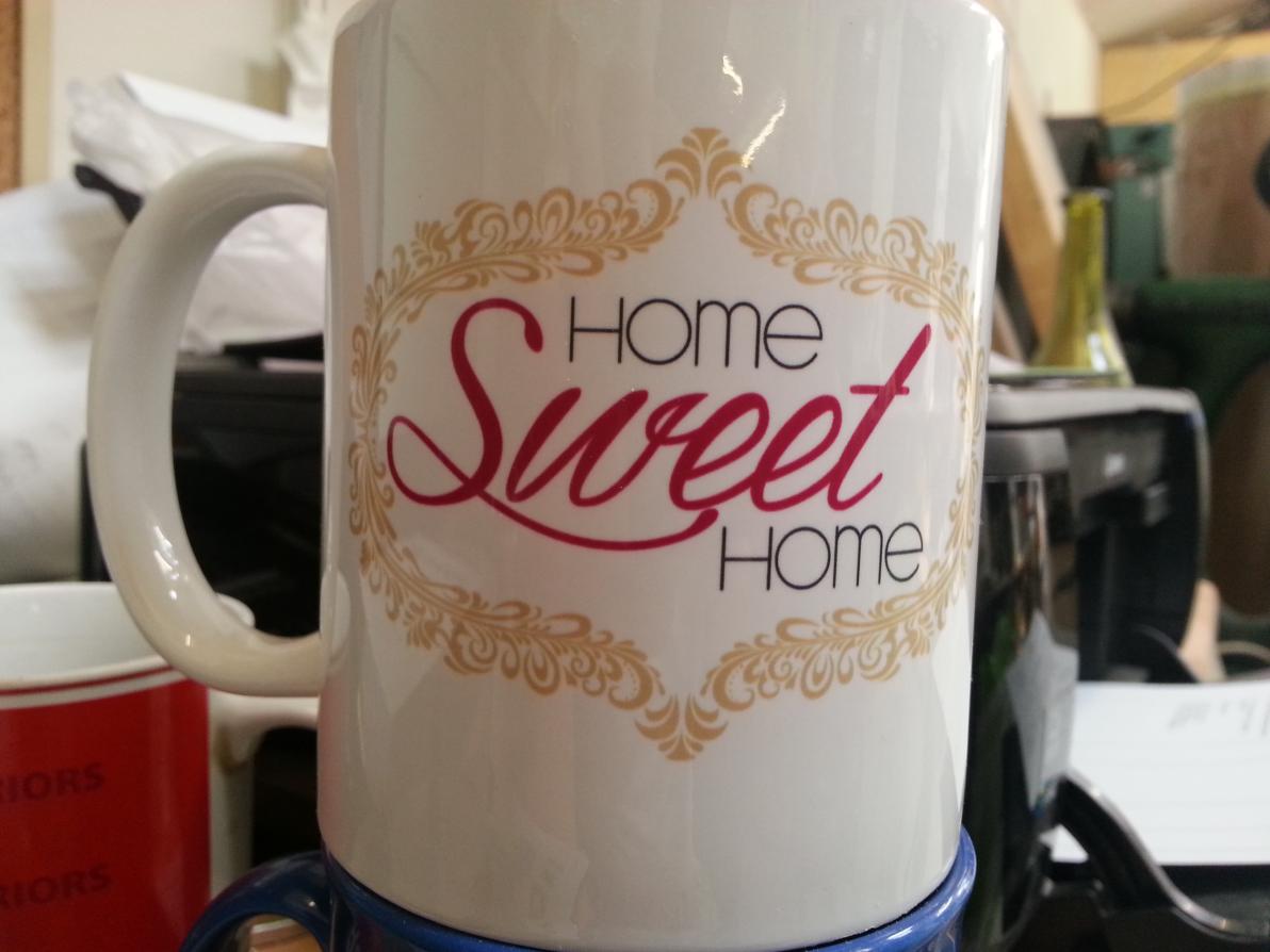

I'm getting half decent results on everything but black, i'll go talk to the folk that sold us the package and see what comes of it

That second mug looks pretty reasonable. Pisquee is right on all counts, and I would definitely get some better, higher release sub paper ASAP.
