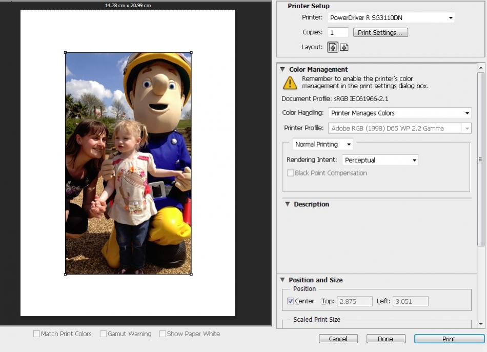

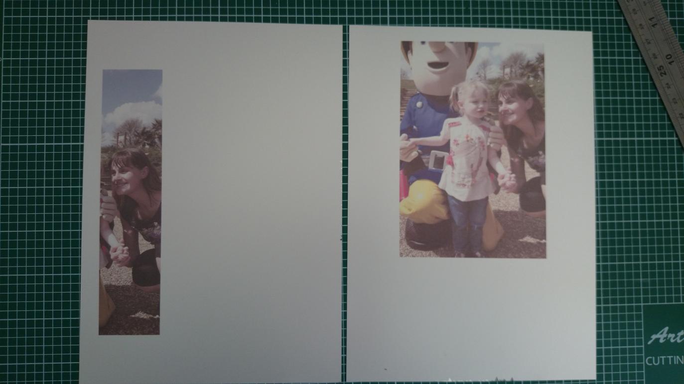

Hi all,
I feel stupid asking this but just can't get it, (I had it fine but obviously did something wrong).
I have Photoshop CC and a Ricoh 3110DN with powerdriver.
My print preview looks fine (see image1)
But when I print I get this (see image2)
I have tried adjusting from portrait to landscape etc and putting the paper the other way round in the printer but end up with partial images (see image3)
Anybody have a clue what I'm doing wrong?

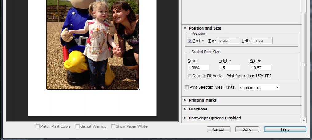

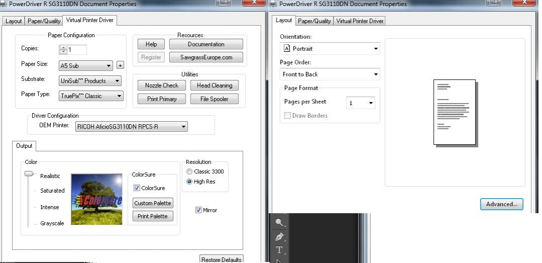

Re: Photoshop Portrait/Landscape Printing Issue...
Hi John,
This was my though as well. It looks like the picture is wanting to be in the centre of an A4 sheet rather than the A5 that is shown in PS.
Are you able to show us the bottom of the screen in Pic 1 and the screen that is shown when "Print Settings" is clicked from Pic 1?
Karen
Karen
Hi Karen,
Sure (please see attached)
I have tried changing these from landscape to portrait and vice versa - Also tried changing in driver settings but no joy.[ATTACH=CONFIG]2492[/ATTACH][ATTACH=CONFIG]2493[/ATTACH]

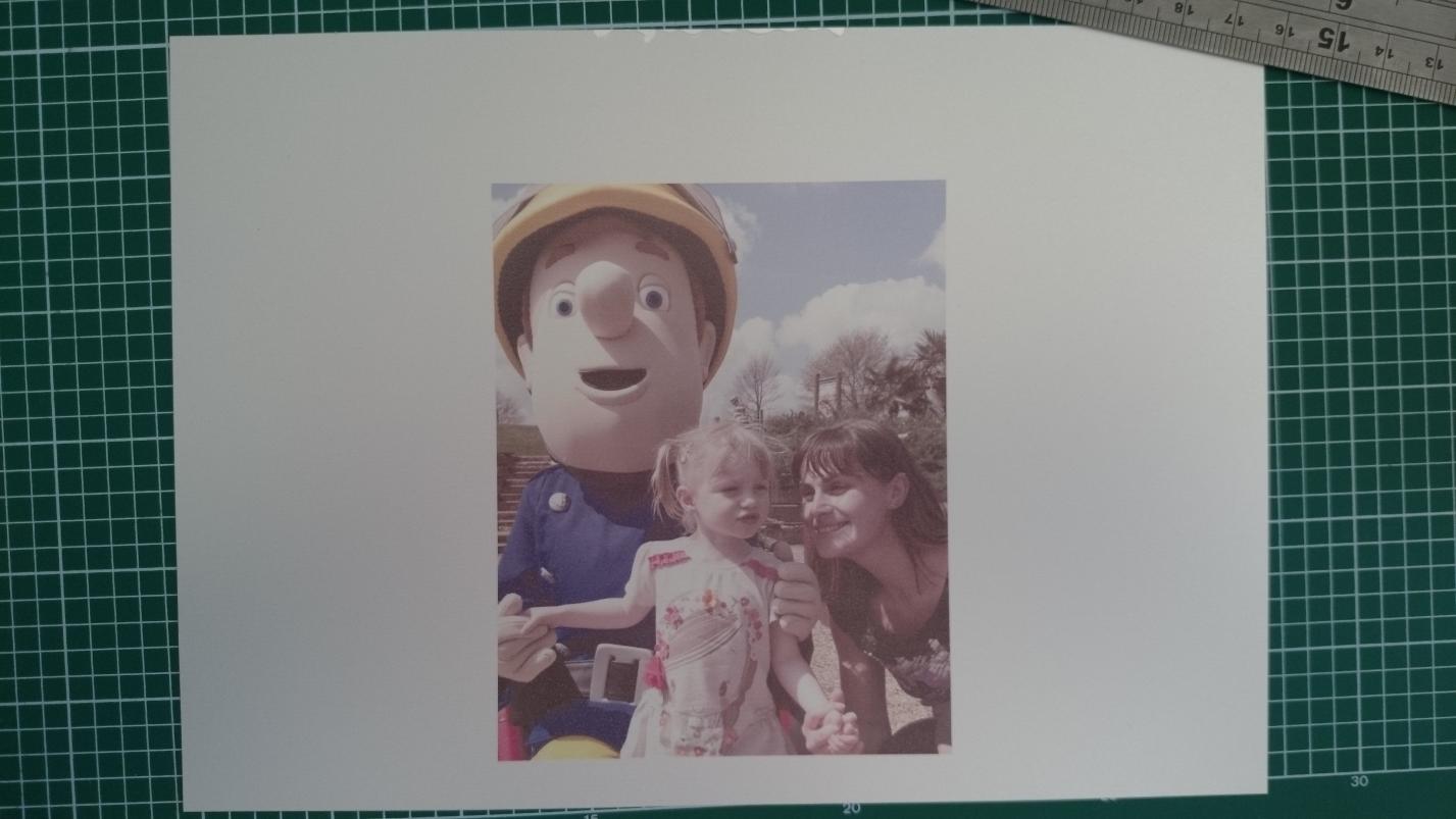

Thanks very much...
O.k re-installed OEM and Powerdriver with no difference.
However, playing around with the printer settings (on the actual printer not on on-screen) I noticed the A5 paper size was 210mm x 148mm whereas all drivers and photoshop were showing 148mm x 210mm.
I changed this to "custom" and input the values the opposite way round. I also switched the way round that the paper feeds to match and hey presto - it printed
I've wasted most of the day but at least it's working.
Thanks again all for your input.
