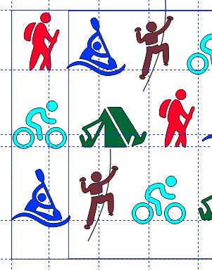

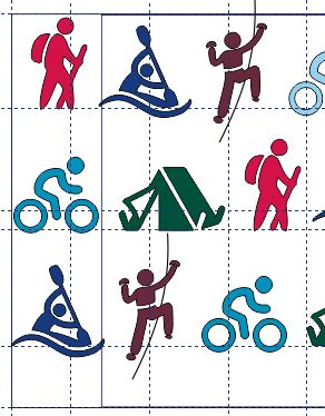

Here's a vector in CD - using Adobe(1998) as the document profile:[ATTACH=CONFIG]2411[/ATTACH] . This[ATTACH=CONFIG]2412[/ATTACH] is what CD shows when soft-proofing using Sawgrass ICC.
When printing, using this setup, the print & mug accurately reflect the soft-proof.
So how do I print something closer to the original?

I could be wrong, but my understanding is that soft-proofing using the Sawgrass (or any other) ICC, will show what the image should look like printed on paper, but not when it's transferred to a mug.
The sublimation process makes the colours change slightly, so thats the whole point of the ICC, to counter-act these changes. I think if the mug looks exactly the same as whats on the paper before transfer, there must be some problem?

well from the screengrab you posted, your ICC certainly looks to be doing the right thing in soft-proof mode. are you basically saying that when you transfer onto a mug, it looks the same as what you've printed on paper...i.e. there is no change in the colours when transferred?

You are thinking in the right direction. The soft proof on screen will give you a good impression of how your final product will print. The soft proof is not to see what the transfer paper will look like - there'd be no point in that. If you want the most accurate ICC for your printer and inks then getting a custom one made will be best.
As softproof gives you a good representation of what is going to print, when in this mode you want to adjust the colours of the artwork to be what you want to actually achieve, either as your original creation, or to match real world artwork that has been scanned in/photographed.
We do this in Photoshop, and use a range of adjustment layer tools to tweak colours and shift them to where we want them to be, or to move out of gamut colours to be in gamut.

I create my own icc profiles and you have to print and then sublimate the colour chart onto a substrate such a white metal sublimation sheet before using the profile device. Then you know the final output is going to proof correctly. You are correct in that many icc profiles show only the result of a scan of the printed page by a colourimeter, which is why you should always find someone who can produce a profile from the finished article or a substrate which closely resembles it.
The soft proof will show what the final output will be, so you should turn it on in Photoshop and then adjust the image with it turned on until you achieve the desired result.
Strangely I found that when I had a working epson 1400 the sawgrass icc profile looked nothing like the final output in soft proof. But the sublimated result on the substrates was perfect so I never soft proofed anything and got the result I desired.
