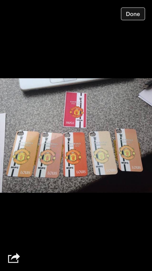

Re: Iphone case, issue with pressing the inserts
[ATTACH=CONFIG]2311[/ATTACH]The top one is the printout, and these are the results im getting
190 for 50 seconds is mine.
How about trying less temp? 170c. I thought ricoh needs less heat? Another bad news is that reds in ricoh printers are very dificult to correct. Even with custom icc.
No new batches, everything has been exactly the same, before i started printing i had to do a head flush and clean on the printer as i had some lines appear, but i dont understand why this would have affected the pressing of it.
yea paul ive tried lower temp aswell, and yes
, there was a badge on the original design but i had the same thought as you so i changed it and the new design wont be having a badge on it
