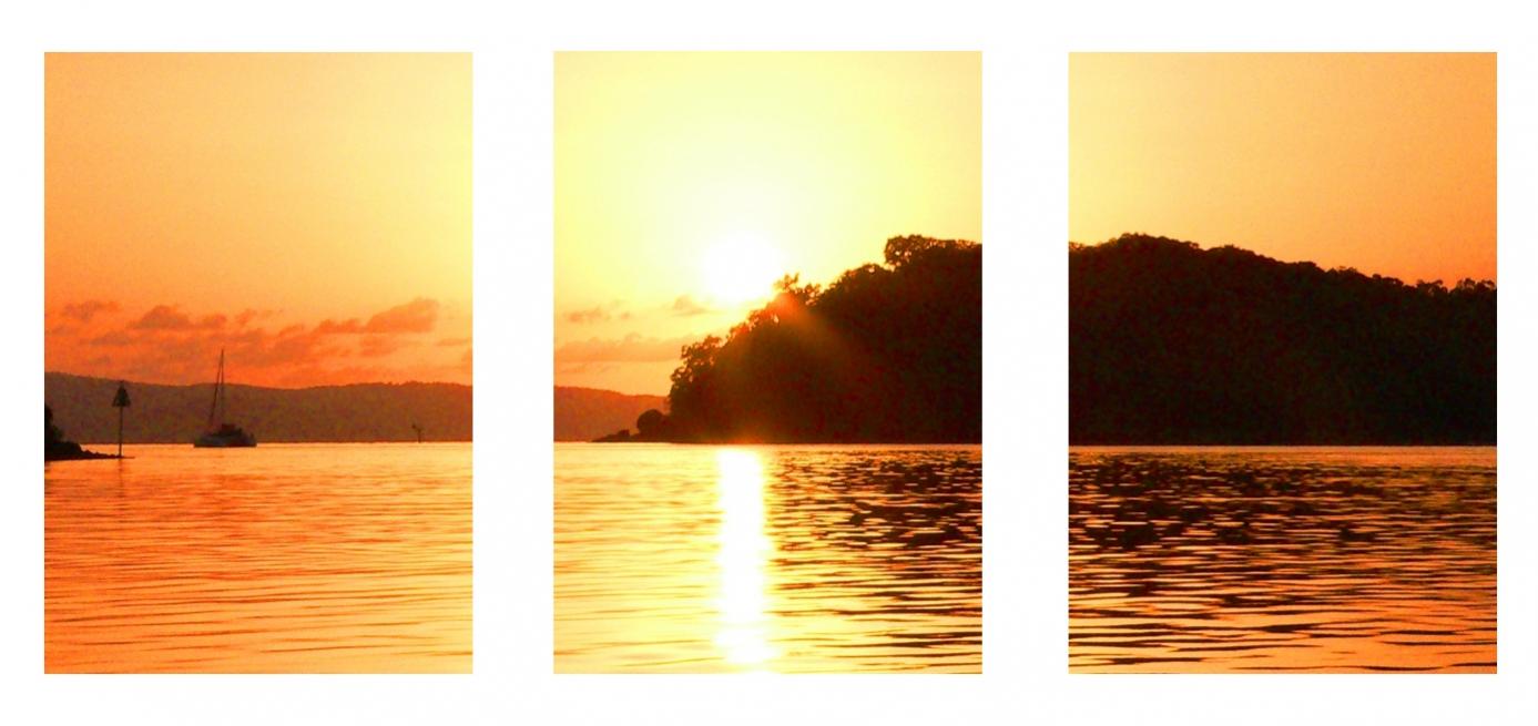

Another thing you might like to play with if you are limited to A4 size for a while. This is 3 separate A4 portrait prints of one of my sunrises. I split one photo into 3 parts, then printed each of them, thinking the customer would put them in a line on the wall. But what they did was staqger them on a wall in a small consulting room - and they look great.
Once you start printing on canvas there's a whole other world out there. I started printing on canvas using pigment ink, then after I started doing sublimation I tried sub on canvas because I was sick of all the nozzle clogs with pigment ink if I go away for a week or two. Now I only print on canvas with Dye Sub. If I can get 100% polyester canvas/dacron I use it, but lately I've just been buying the pre made frames because they are cheap, bright, and there is no 'work' to do other than spray - press - spray.
With the Brother A3 printer for Sublimation I know I can be overseas for a month and a half and the thing just works when I get back. Just a single nozzle check and clean. I think Ricoh is supposed to be just as good.[ATTACH=CONFIG]2234[/ATTACH]
