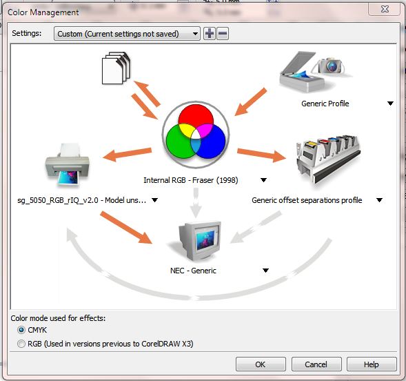

[ATTACH=CONFIG]2005[/ATTACH]
Hi Paul,
I'm not sure, these are the settings in X4 which I have been using,
thanks
Hi Paul,
thanks

you have CMYK set instead of RGB
Re: Matching colour management in Corel X6
Is that not right? I've always had CMYK set, I'm not sure how I originally came to these settings but these are what seem to work and so this what I have always used.
Incidentally I thought the monitor profile would just affect how the colours appears on screen but it also has an affect on the print colour too.
