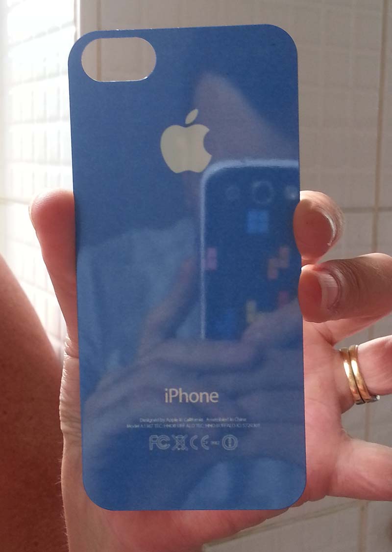

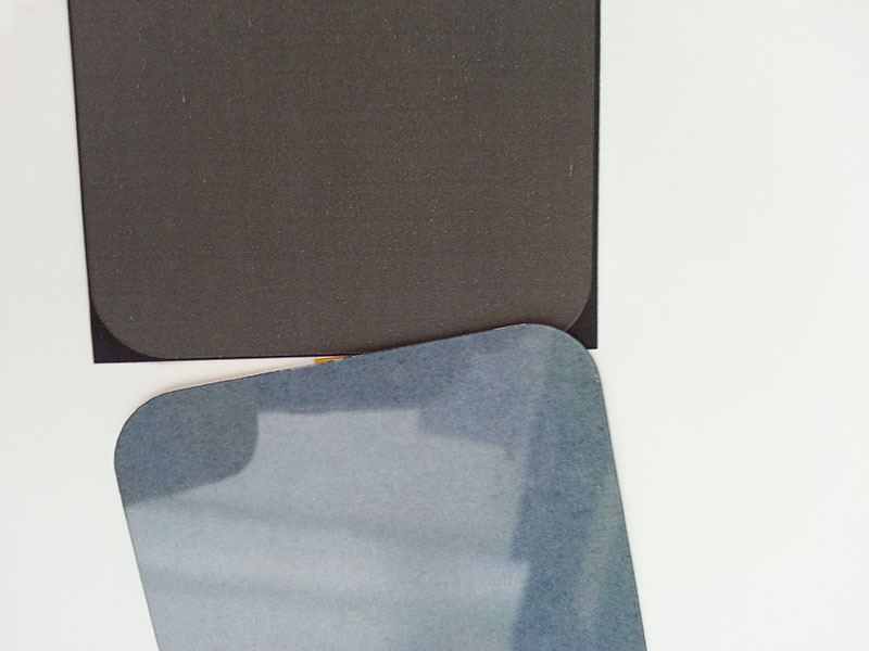

I am a sublimation noob and I have set up a small business doing iphone covers through sublimation.
My issue at present is faded black images.
Every other colour comes out perfectly using my setup.
I have tried numerous times to print with numerous settings 170 -190 degrees with 60 up to 120 seconds but no avail, the other colours look great while the black is very matty and faded.
I am using Photoshop Cs6 with Powerdriver, I followed the Sawgrass guide to a tee in setting up the printer etc. I am using truepix setting for paper and perceputal in cs6 setting and saturation in powerdriver setting.
I am using paper from Coralgraph and a coralgraph Heatpress also.
The print outs seem to be much darker than what ends up on the sheet but at the same time leaving it for longer time/ more pressure/ extra temp doesnt change the outcome.
I also have taken the plastic off :)
I will try upload a few photos to the post now.

to me look like printed on wrong side of paper as it look grainy as hell :)

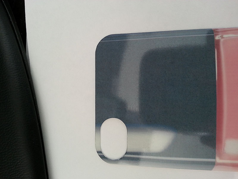

Paul, I have been printing on the shiny side but this paper's shiny side isnt all that shiny :/.

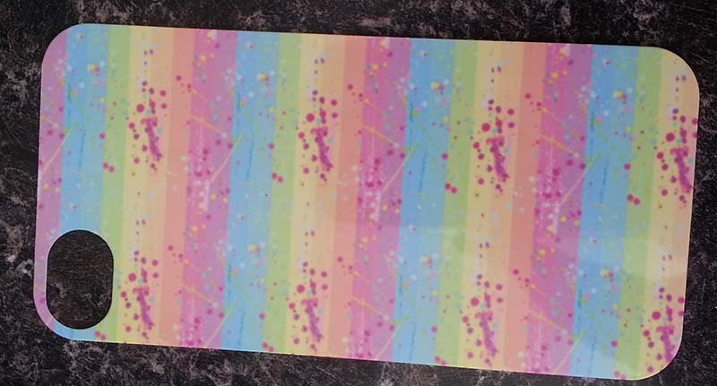

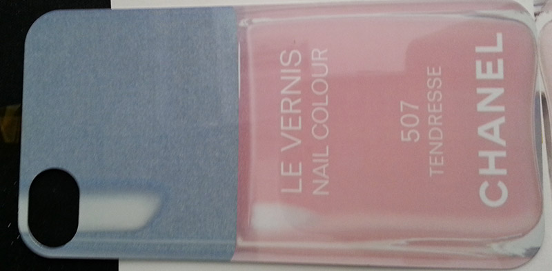

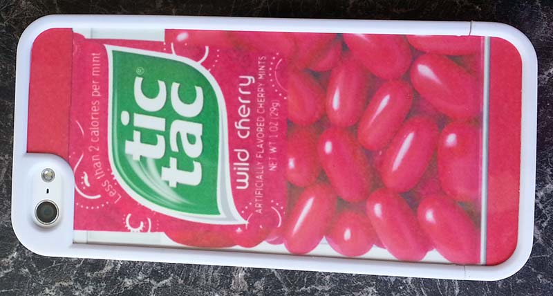

Ill try the "matty" side now to be sure (I tried and its much worse on the black see pic below) , ill attach some non black ones and they look really good but anything with black is fairly pants.
