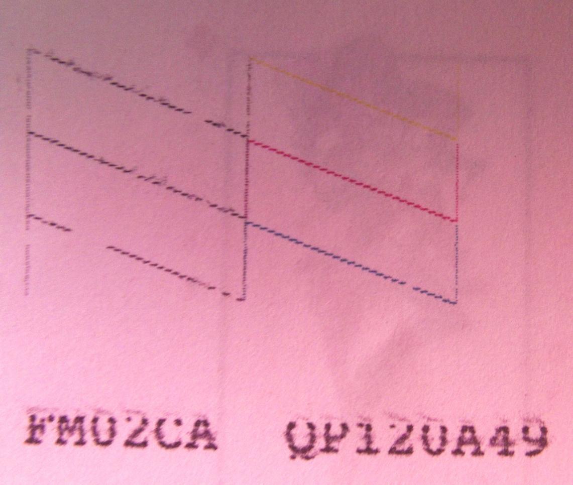

Hello,
I had noticed this morning that I must need to do a head clean as I had lines accross the black ink. I have now got to this evening and done what must be 100 head cleans and it is still the same. I have tried to flush out using alcohol but it does not seem to work. Does anyone have any ideas?
The printer is epson sx235w.
I do not really have time to order anything as a replacement as I am now very behind on my orders. On the test print after the clean there are still lines on the black, and the tops of letter and number sequences below that have a blurred top to them as well as lines through.

hi. you dont want to do more then 3 to 5 head cleans. this can damage heads for good. when you said "flash" what did you do?
Re: Printed clogged? Printing lines...
Are you using refill carts or a CISS?
Does the printer print properly if you put Epson carts in it?
Fold a piece of kitchen roll so that it fits in the channel under the print head.soak it in alcohol. Slide the print head over it a few times and then leave it on top of the kitchen roll overnight.
Alcohol can be too harsh, and printer cleaning fluid/flush should be used -if- it is actually the print head which is blocked and not just a flow problem from the carts/CISS.

Just tried many of the things above and still nothing. I have attached an mage of what the test looks like just in case I have miss understood something.
[ATTACH=CONFIG]1906[/ATTACH]
