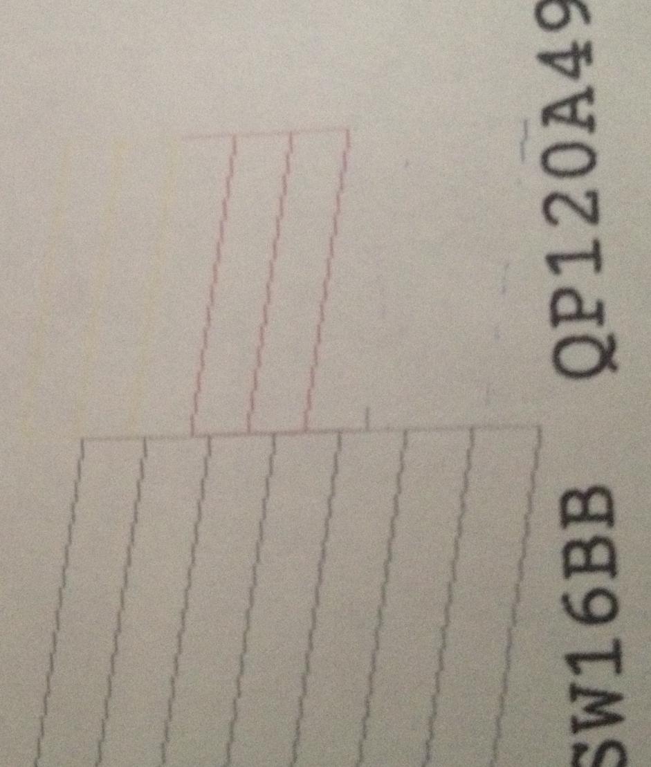

[ATTACH=CONFIG]1826[/ATTACH] heres a screen shot, i have ran the clean heads and nozzle many many times but not difference. any suggestions would be fab, as am losing the will to live here xx

I think the Cyan head is going to cause you a major problem with this but that is as far as I can advise because I do not know anything about Epson's (sorry I am a Ricoh man). However there MIGHT be a work around.
The file you are printing from. Check the colour breakdown of the black. Change the colour range to be CMYK and then make sure the text you are printing is 100% Black and not a mix of CMYK.
The other thing you could try depending on what software you are using is printing the file as a greyscale or as black and white (assuming there is no colour anywhere). That should mean the only head that is used is the black which is operating as it should.

Are you sure that it is actually a blocked head, and not a flow problem from your CISS or cartridges?

Problem is cyan is more prone to blockages i was plauged by them using an epson 1400. If you havnt cleared it after a few head cleans then you have problems. Cleaning fluid may halp but personally ive had limited sucess , try the original carts if you get a good nozzle check then you know its not the printer. Chances are you will need a new cart assembly assuming you are using a ciss or worse still a new ink tank set. I suppose you could try drawing the ink through (priming) by using a syringe and needle in the bung on top of your cyan cart
