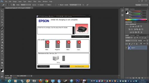

Post by scottmurray89 »
[ATTACH=CONFIG]1552[/ATTACH]
still no luck, thats what comes up when i try to print, ive tried resetting the cartridges and reinserting them, but still nothing, when i disable the epson status monitor and try print nothing happens at all, the print job just stays in the queue and nothing happens, has anyone any suggestions on what could be wrong? thank you
