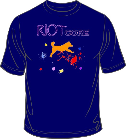

Sorry I should have been clearer
Roger and I own Versacamms (there maybe others on here also). Our printers can print white which means we could take the image, print it on C-PRINT CRYSTAL which is a transparent heat transfer paper, and back the image only with white. To give you an idea of what I meant I have quickly placed this on a navy tee.
[ATTACH=CONFIG]1540[/ATTACH]
As mentioned it would not be cheap as I think the image would need a double hit on the white and if the job came in under £20.00 just for the transfer I would be surprised.
TMT WOW would be the cheaper option
