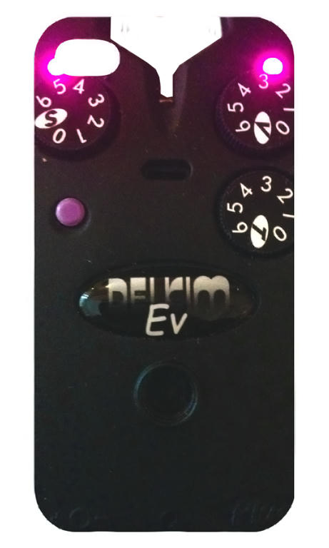

on a pic someone sent in for an iphone case.
blacks going brown - to much heat ? or to much time ? - to much pressure ? or a crap pic ?
off to try again :rolleyes: - prob them all lol
here is the original pic from customer -which has been cropped and brightened up, cause it was really dark
http://i1264.photobucket.com/albums/jj4 ... cdc1c4.png
and heres what the thing is turning out like
http://i1264.photobucket.com/albums/jj4 ... 9db5b6.jpg
have tried lowering temps, less time, less pressure, nothing.
black come out fine on mugs

If you're using a Ricoh I'd say it was too much heat and/or time. What settings are you using?
Re: blacks gong brown again
ha - wished i was justin - brother 5910dw :rolleyes:
temp -180 -time - 180 - presure -heavy
tried temp-175 - time - 175 - med pressure - still same
blacks come out fine on my mugs -so inks are ok
the first setting has worked fine for all other colours - bar tonight with the black

bigJ! your image is brown
not to much but i can clearly enough see that is lot of brown in it!
