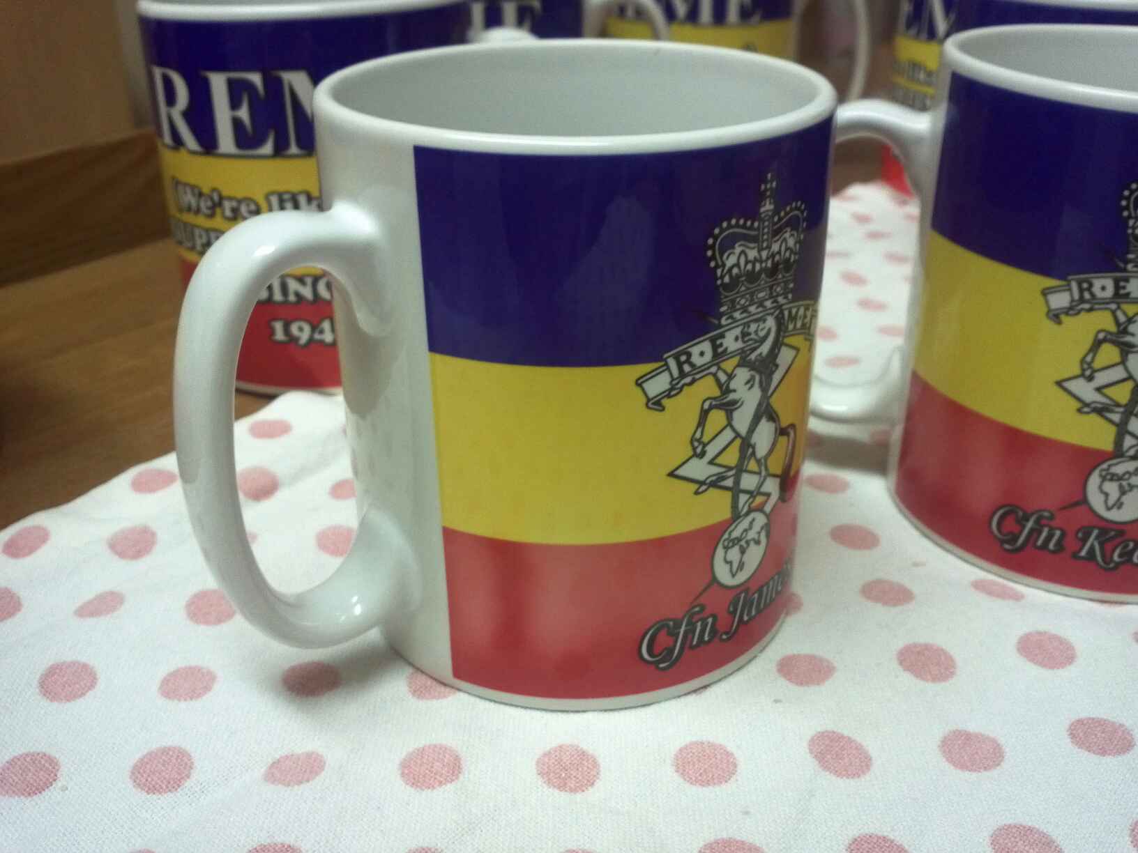

Hi Guys and Gals,
Im sure you guys are used to folk tipping up, saying hello, asking a question, getting an answer and buggering off but i can assure you that we get the same on all the sign forums so i aint going anywhere :).
Before posting this question i spent ages looking through the problems section so that i could possibly find the answer myself but it was very hard to try and understand what people were describing so i thought id just smash up a photo and ask, WHAT THE HELL AM I DOING WRONG TO GET ALL OF THESE BLOODY LIGHT PATCHES?????
Ruined about 13 mugs today, not a good start :mad:

Looks like a lack of pressure. Also I know it may cause a bit of a discussion on here... but I tend to stay away from solid blocks of colour if I possibly can. It just highlights any small imperfections in pressure/mug shape/sub coating coverage....

Mug press or wraps and oven..
Could be a number of things.. but looks like lack of pressure or blanket issues ??

Wraps and oven Renniwano.

Re: Flippin Faded Bits!
what time and temp??

9 minutes turn over for another 9 at 175 degrees.

I also use wraps and oven, and as others have said it looks to me that you need more pressure. I use the heavy duty clamps from BMS and set them so they need some real effort to close. Might need to use an extra sheet of paper or a smooth silicone sheet as at the pressure I use I very occasionally get the pattern from the inside of the wrap on the mug.
