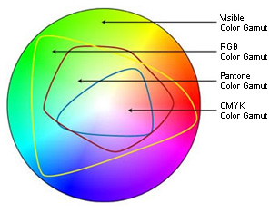

[ATTACH=CONFIG]1323[/ATTACH]
Does this answer my question?
Am I correct in thinking
1/ The cmyk colour scheme is inside the blue line, only colours within this blue match the colours of RGB.
2/ The colours inside the red line but outside the blue will be an RGB colour that CMYK is capable of doing an approximation of but it will not be exact and may indeed be no where near.
3/ The yellow line encompasses all the colours available in RGB. Anything outside of the red line cannot be done in CMYK.
4/ Beyond the red line is colours we can see butu cannot accurately reproduce using RGB or CMYK.
So I cannot reproduce Barbie pink because I am limited by the colours available on a CMYK printer.
Am I right there or am I barking up the wrong tree?
If I am right then does that mean all my designs need to be solely in the CMYK spectrum (pallet) to ensure correct reproduction, and it's by luck that my designs in RGb have been OK!!!

Re: Help! Barbie Pink
Hi Earl
Posts crossed there.
The magenta is somewhat subdued and is what was printed on my mug.
So am I right in thinking that really bright pink cannot be reproduced using a CMYK printer?
Ok fishing about on the Tshirt forum and found this from the Calafornian God of print colour
"Good luck with trying to print bright pink, but my first instinct is to say that you are not going to hit a "bright" pink (Fuschia) color range, simply due to the limitations of CMYK printing. You might come close, but it will always pale in comparison to, say, Fuschia plastisol ink, or Fuschia transfer vinyl. It is important to know the strengths and weaknesses of each printer, as well as of the industry on the whole."
I have just gone pink crazy here [h=3]CMYK Selected Color Codes - December Communications, Inc. december.com[/h]The pink I was searching for is not to be found in CMYK.
I have learned that the really eye popping colours are not achievable, Lime Green being another one.
Hmmm time to talk to the client, this is going to be a bugger!
