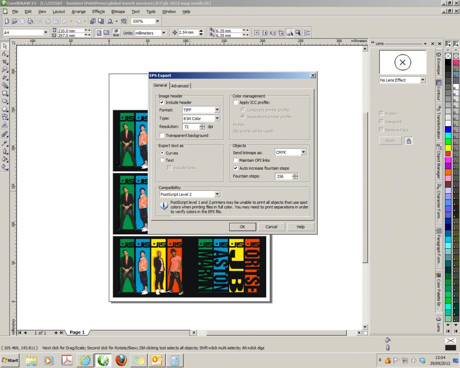

Re: Help and advice
Really easy Jennywren
Open the file in Coreldraw
Hit "CTRL" + E (Or goto "file" and scroll down to "export")
Top part of the window that opens is a standard windows box.
At the bottom you have three options
FILENAME (Which is self explanatory)
SAVE AS FILE TYPE (which you can select whatever works best for you (I recommend EPS)
Sort type Should read default
Click on the button in the bottom right that says EXPORT
A new dialogue box will pop up which should be set to the correct settings. I have attached a picture which shows you these standard settings. Clicking on the advanced tab gives you other settings but you should not need to touch them
[ATTACH=CONFIG]1208[/ATTACH]
vB_ID:1208
vB_ID:1208
