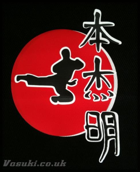

Never Layered before let alone use luminous and glossy vinyls but thought id have a go and do a top for the son for under his martial arts gear.

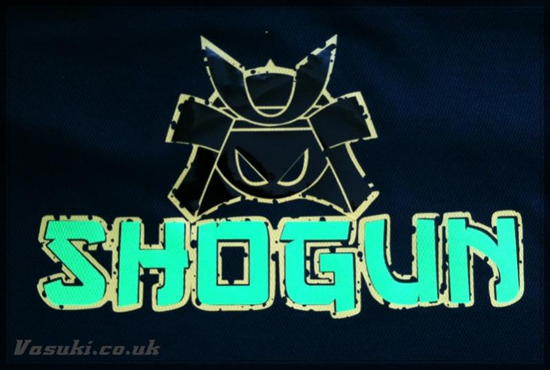

Not 100% happy with the sun on front logo could have got it sharper but quite pleased with the back Shogun which i did in Inkscape (thanks for heads up on that Paul)
Any tips or pointers to improve layering welcome.
Lee
[ATTACH=CONFIG]1089[/ATTACH] Front Logo Japenese spells (Benjamin)
[ATTACH=CONFIG]1090[/ATTACH] Shogun i did in Inkscape , quite pleased with the back could have got letters better aligned but oh well ;)

Like it.. do you use registration marks when you layer vinyl.. or do you do it by eye ??

Looks pretty good to me.....

I like them! How did you achieve the speckle effect on the light coloured back layer of Shogun?

@Hidihi
I did the speckle effect in Silouhette Studio , I did a 2mm offset then I basiclly made a layer of circles of different sizes grouping & duplicating untill i got a look i liked then ungrouped the text so the offset was seperate overlayed the circles on the offset and used the subtract which cut the effect into the image , then moved the text back over and regrouped.
Sounds confusing reading that back but its really simple , i then cut the back offset part in one color and the original text in another and it worked :) Though im sure there as to be a quicker way around it.
@ RogerC
No mate , I did it by eye , I did watch a video on using registration marks but i pressed each layer seperatly due to variation in materials (some cold peel some hot , mat & glossy) still on a huge learn curve only just scratching the surface , Aren't reg marks for mainly decals ? Just wondering how youd use marks without them attaching to the fabric ?
Thanks for the positive replies much appreciated ill post a few more when i next play :)

Thanks Lee, your explanation makes perfect sense! I think I might have to have a play and see what effects I can come up with :o)
