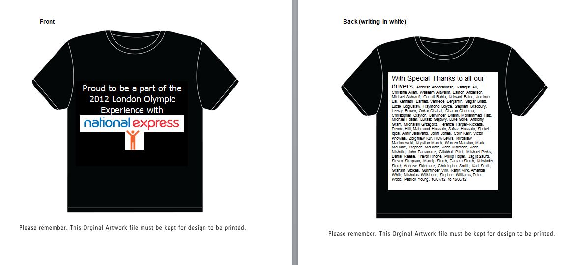

Hi all,
I have had an order from National express for 60 T shirts.
They want black with text. I thought that would be fine, and i could use my plotter.
But they want tiny writing/names on the back and colour on the front.
How would I do this?
Would i need a transfer paper and use sublimation?
Please advise
Tony

How do I sublimate white? There is no white ink.
Re: How to do this?
...another question is whats the point of sublimation black tee?? :)
in my opinion you should get this screen printed or screen printed transfers so you can press them yourself.
Re: How to do this?
You can only sublimate onto white/light tees. DTG probably your best bet, some transfer papers possibly. Screen printing is also an option on an order of that size.

Where could i order Screen printed transfers to press onto the shirts myself?
I need to quote them a price asap.
I can get the Tshirts easily enough.
Re: How to do this?
I've not bought any for a few years now so hopefully someone else will be along shortly with a recommendation. I know Target Transfers do them but unsure about prices. I'll try and dig out the name of the company I used last.

i use a guy called lemonade screen print i'll sort his number out in the morning when i get to the shop

BMS do a Dark transfer paper, never used it myself but here's the link http://www.printerowners.co.uk/sublimat ... -paper.htm

I dont see why you cant do in vinyl. If you choose a font that it is not too enclosed I cant see why you couldnt do it with vinyl.
