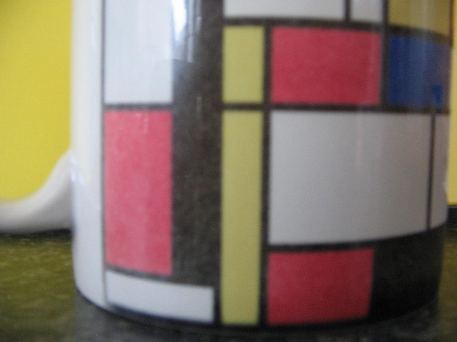

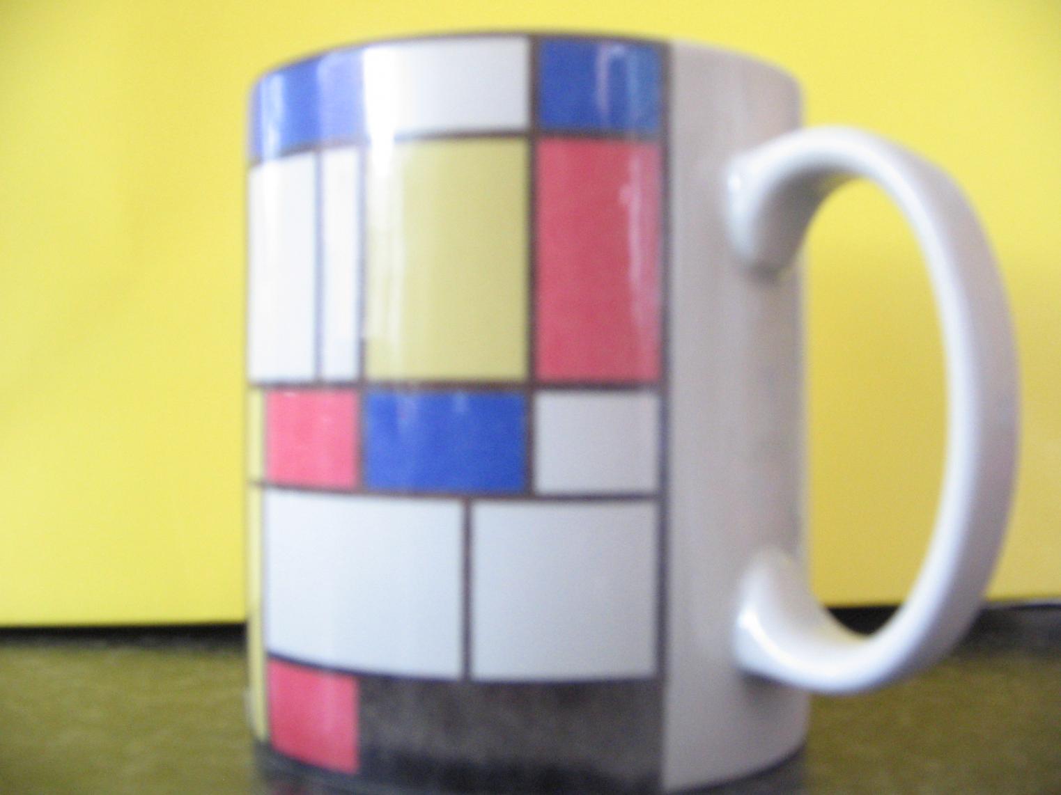

[ATTACH=CONFIG]203[/ATTACH][ATTACH=CONFIG]204[/ATTACH]
These are the mugs so far.....I think this one is going to cost ME money :-\ Could thi be that the image quality was sent to me as 72dpi - internet quality, not print quality - although I did adjust it...
When you say turn the mug - how so? The DF1 closes around the handle space at the top - I cant understand how I could print it in a different position...
The cust wanted full wrap, I may have to reduce the size to show some white edges top and bottom and more near the handles, hopefully this might avoid the fade...?
Should I be refusing jobs that aren't at the right dpi - as my adverts state - and ask them to resend better images.... but I dont want to lose what little business Im currently picking up....!
Headache!
Headache!

first of all there is no such a thing like "adjusting image from 72dpi to 300dpi" you can change the settings but it wont impove image at all! if this would be so easy then photographers would not buy expensive cameras with lot of megapixels.
second. it all look like not enough pressure or I had similar when i printed on wrong side of sublimation paper. are you sure you printed on right side???
third:
third:
I would not advertise till i master it a bit more. if you get customers and start to mess with the mugs etc... you may loose your reputation on start. so is good to practice first...Should I be refusing jobs that aren't at the right dpi - as my adverts state - and ask them to resend better images.... but I dont want to lose what little business Im currently picking up....!

Thanks Paul - I'll try again - I have bumped up pressure already, and other mugs I have completed are fine - it just seems to be this image thats has been sent to me...which is why I was questioning quality of the image... The paper is loaded in the printer shinier side up - Im going to turn the top sheet over and try that!
Watch this space!
Watch this space!
Re: Printing problem....?
Interesting....now Ive turned the paper over to rougher side up in printer tray, the printed mage is a lot more vibrant on the paper..... before it prints quite dull.....now to press it....!
