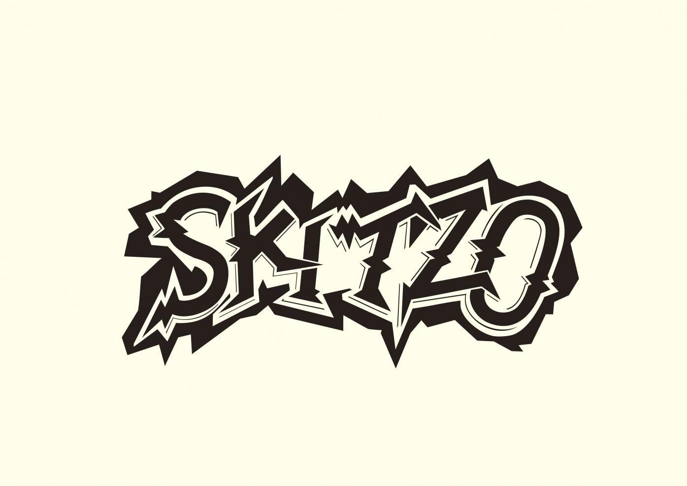

How can I get this jpeg converted so the Craftrobo will cut it onto vinyl?
It looks like allot of weeding to me!
[ATTACH=CONFIG]139[/ATTACH][ATTACH=CONFIG]139[/ATTACH]

what software do you have?
hardly any weeding there ;)

Sorry if I sound stupid, but what do I do with the file. The Robo master software will not read it.
Re: How to?
right ;( you can open it with corel or illustrator. Also you can cut it via corel too.

Trying to upload an eps that's easily cutable but its saying file invalid.
If you have coreldraw do a simple or quick trace, delete the background, trim the white onto the black, delete the white then weld the rest. Export as an eps then import the eps into your cut program.

I can see your eps Paul but its a little pixelated to cut directly - i've done an eps file that's simplified but cannot upload it. Is there any way to upload an eps file - how did you do yours.

Sorry Paul, just checked your eps again - it could be because there's a faint background that could be confusing the CR. Take that off the it might be usuable.
