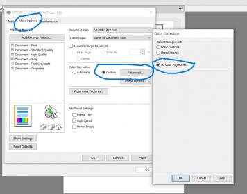

You must set the profile in the apps print dialogue and then turn off colour correction in the printers own print dialogue.
In the print dialogue for your design software - select colour controlled by app ( or something similar depending on the app) and then choose the profile that matches your ink/paper/printer
After you have done that then in the printers own properties dialogue box click the more options tab and under colour correction select custom and click the advanced button. Then check the no color adjustment box. (screenshot attached using ET2710 - yours should be similar).
Of course all of this is assuming that you are using a PC. If you are using a Mac or iPad then you have no control over colour output. Macs o/s overrides the profiling you cjhoose in favour of its own native profile.
[ATTACH=CONFIG]7412[/ATTACH]
