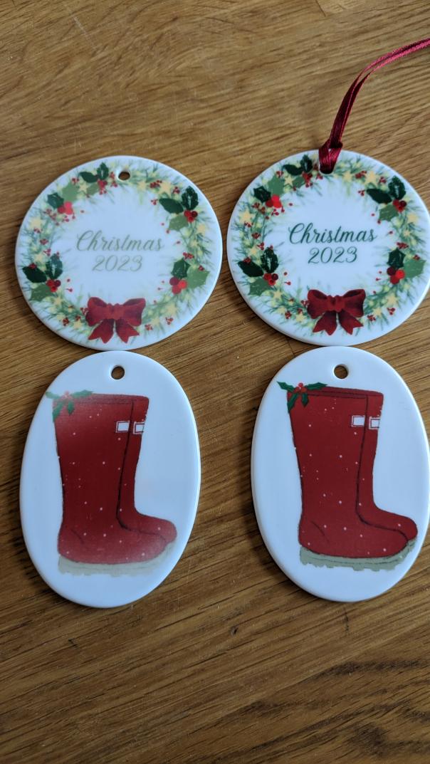

[ATTACH=CONFIG]7240[/ATTACH]
I did 40 discs yesterday and got 18 that could be used. This order is costing me money. I have tried small increments of temperature and time and when I get a good result I try that again and get a different result. These ones in the photo where at 195c for 120 seconds. I did everything exactly the same and got different results.

If everything is staying the same then the only logical explanationg would be the quality of the product being printed onto or rather, the coating of the products. Speak to your supplier. We don't allow their name to be spoken on here for good reason so please don't mention them ;-)

Now I would say it’s pressure that’s the issue?
looks like it’s not enough pressure on those ceramics I have had a similar issue.
and mugs tend to go the same way when they aren’t straight edges.

Are you printing several at same time? Or always printing in same position? Any cool spots on your platen?
