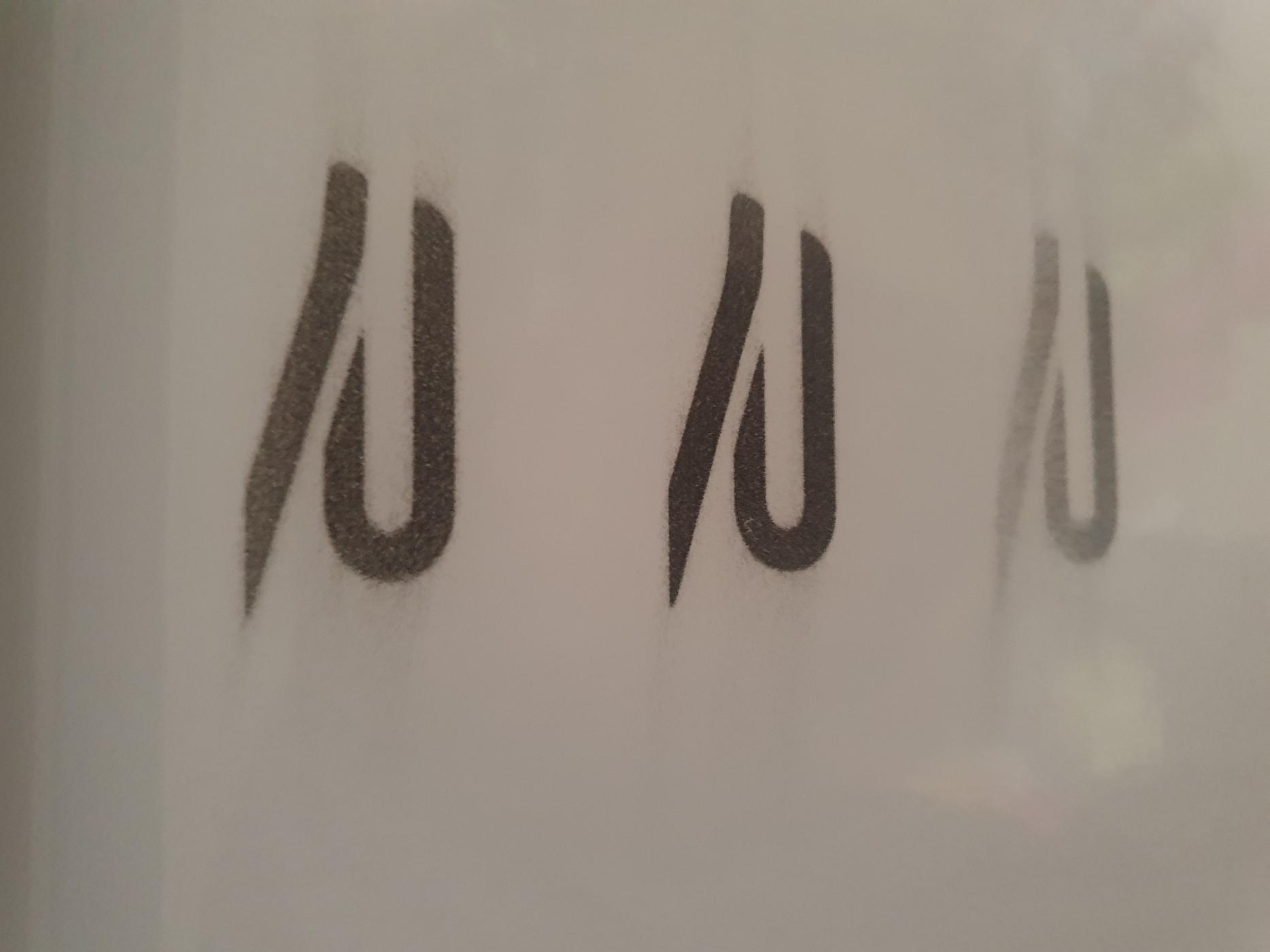

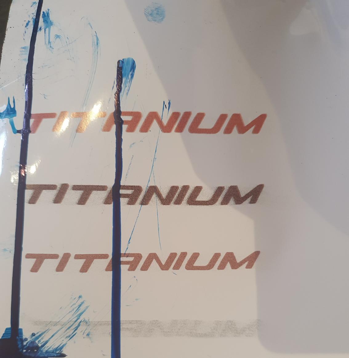

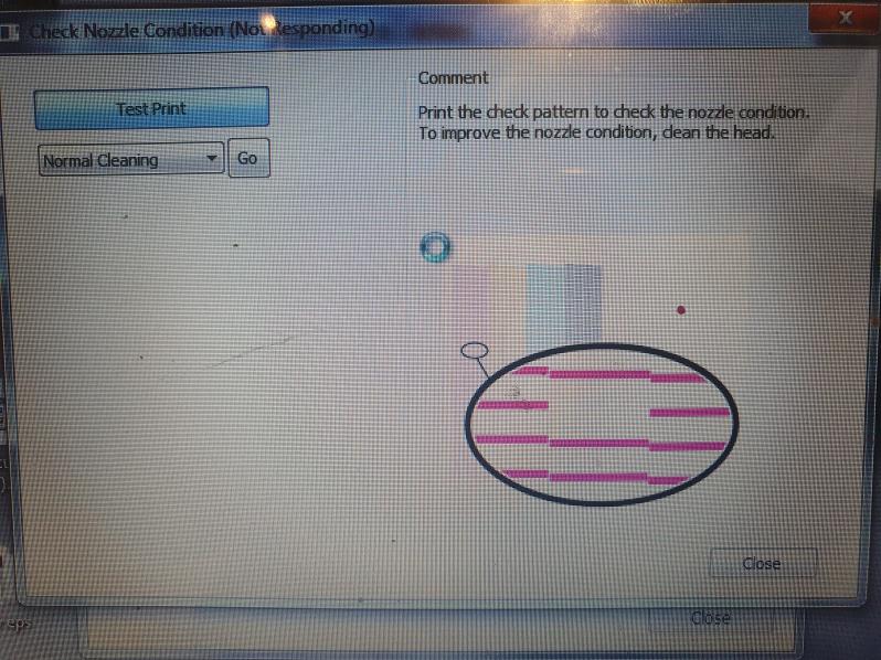

Hi All,
The past 2 days my printer has been printing very faint and often the wrong colour. I have cleaned around print head and the cap station and ran multiple cleans normal/powerful which enables the ink to work short time then return to the smearing and faint prints.
I have noticed there is quite a bit of settled ink in the cap station which I will try and clean out once the new cleaning solution is delivered tomorrow.
Another issue is the Nozzle condition whenever I click test print the entire Versaworks Studio freezes so I am unable to perform this task I am not sure why.
Any advice would be greatly appreciated, I have attached some images also.
Thank You

Re: Roland BN-20 (Nozzle condition & Smears)
is this after the latest windows update?
If you open task manager is your cpu at 100%
I personally Would start my machine (pc) in safe mode and try to print a nozzle check and see if it still crashes.
If it doesn’t then maybe try reinstalling versaworks that blue looks a bit like it’s flooding and not firing right from the print head.
Do you have a local engineer you can call up?
Edit: I have noticed your using max 3 inks too.
my engineer told me to steer clear of max 3 maybe this is why??

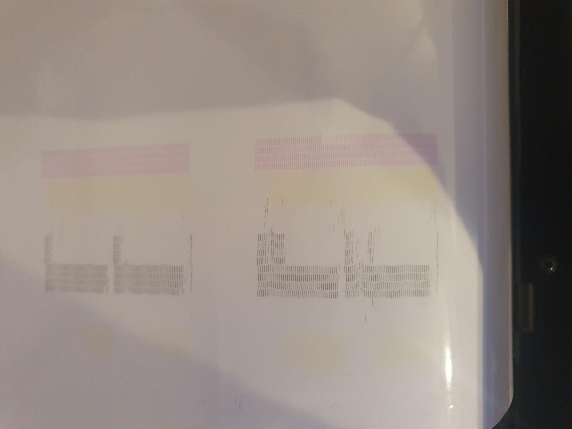

i have done several cleans now and also manual cleaned the printer from top to bottom.I also provided a head wash and ink pump the good news is there is now no smudge or ink droplets.
The bad news is my colours are now not printing clearly and are faint and not clear, Any recommendations would be appreciated.
Are you using a specific profile or general vinyl settings?Focus1;148072 wrote:i have done several cleans now and also manual cleaned the printer from top to bottom.I also provided a head wash and ink pump the good news is there is now no smudge or ink droplets.
[ATTACH=CONFIG]6626[/ATTACH]
what does your nozzle check look like?
The image above looks blurred and not at all defined.
Have you been removing the inks and shaking them regularly.

I have managed to do a nozzle check, the Cyan is is it non-existent. I am now baffled and do not know where to go next is it work contacting an Engineer?
