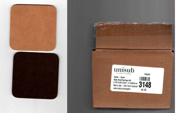

Only when I studied the inner box did I see the Unisub matte label as shown in the image below.
The backs are a different colour too - much lighter on the matte than the gloss backs (both shown in image) and a bit annoying if supplying a repeat order not to be able to match. The real deal breaker though is the back breaking up after pressing.

Yep, 3148 which is either very old stock or just a mix up from Unisub.
There will be closed for the weekend now, but contact Xpres on Monday morning about this and you will have 4026's delivered on Tuesday to replace no problem.
