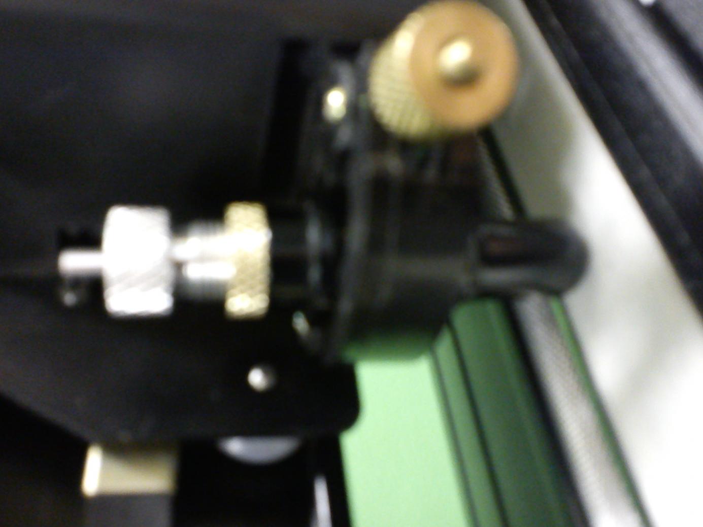

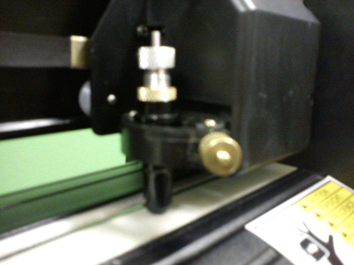

bought this cutter package on tuesday and received but can't figure out how to install blade (haha).
http://www.lovecut.co.uk/24-full-sign-m ... -365-p.asp
been told by lovecut it just sits in clamp but when put it in clamp the blade is not showing through black cap thing on end so how does blade come out when you press cut.
Hope someone can help i'm getting rather stressed out with it.
I've attached some photo's of blade holder.

There's no decent image of the cutter or the blade holder. Can you take a pic and upload so we can see what you're referring to. Might get some feedbacknthen from others...

I've attached some photo's of blade holder to top post.
I'm getting sick now lovecut are not helping and manual doesn't say anything just really small black and white picture

Hi Matthew,
Take the blade holder off the plotter, run it along a scrap of vinyl and see if it cuts. If it doesn't leave a mark, unscrew the top silver and brass nuts together, but only a quarter turn, now screw the silver bit but not the brass, this will lower the blade - the brass bit is just a locking nut. The blade tip needs to be just showing, we're talking a smidge, hold it up to the light and you want to just see the blade tip. Once happy tighten the brass without turning the silver. Pop it back in the plotter and do a test cut, set the pressure so it cuts the vinyl but not the backing sheet - it should only just mark the backing. The vinyl i'm talking about is the sign/vehicle livery variety but its the same on t'shirt vinyl but maybe a little more pressure.
Hope this helps.
John
