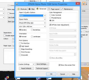

You also need to turn off colour management in your printer driver. Select the ICM box and tick ' OFF ( No colour adjustment )'.
Pic shows process on Epson 1500 - yours should be similar.
Also check that the image you are printing is in RGB mode, not CMYK.

The colour management had already been turned off before I began the print tests with the Epson printer.
