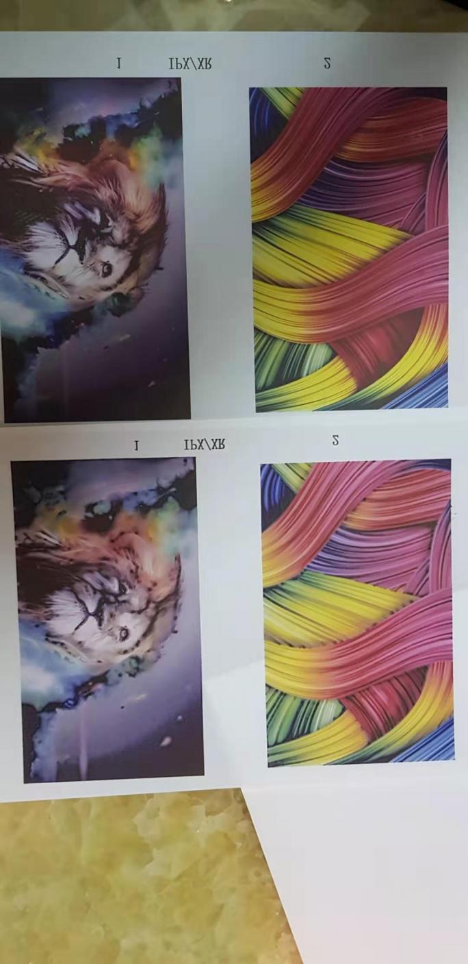

Re: How to use Sawgrass printer to print on 3D Sublimation Film
Hi Justin,
Sorry. I didn't mention it clearly.
We are using sawgrass SG400 and SG800.
The ink is always too much.
Too compare, please see the attached picture.
Upper one is printed by sawgrass printer SG400 and sawgrass ink.
The bottom is printed by EPSON Printer with Korea Sublinova ink.
You need a specific profile to use the film I'm afraid, what's happening is you're overloading it with ink. You could play about with settings in your software to help reduce this but without a profile you'll never get the right results.

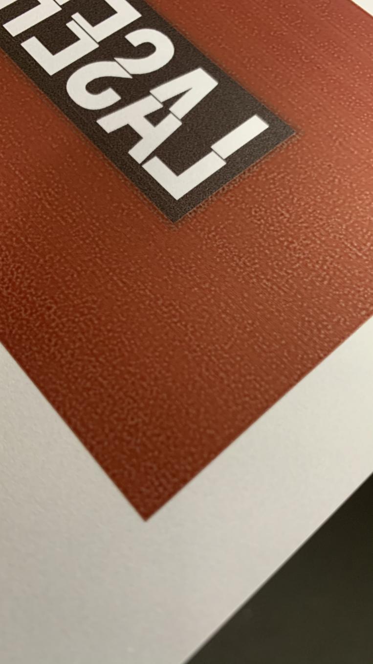

Hey Justin, just joined the forum and i believe i am having this same issue. I use a SG500 with Korean film and tried to use the sawgrass print mangers settings with very poor results. I attached images to show you what I'm working with. If the ICC profile is what i need how do i go about finding or installing the correct profile? Any help is appreciatedJustin;141120 wrote:You need a specific profile to use the film I'm afraid, what's happening is you're overloading it with ink. You could play about with settings in your software to help reduce this but without a profile you'll never get the right results.
[ATTACH=CONFIG]6426[/ATTACH][ATTACH=CONFIG]6427[/ATTACH][ATTACH=CONFIG]6428[/ATTACH][ATTACH=CONFIG]6429[/ATTACH]
