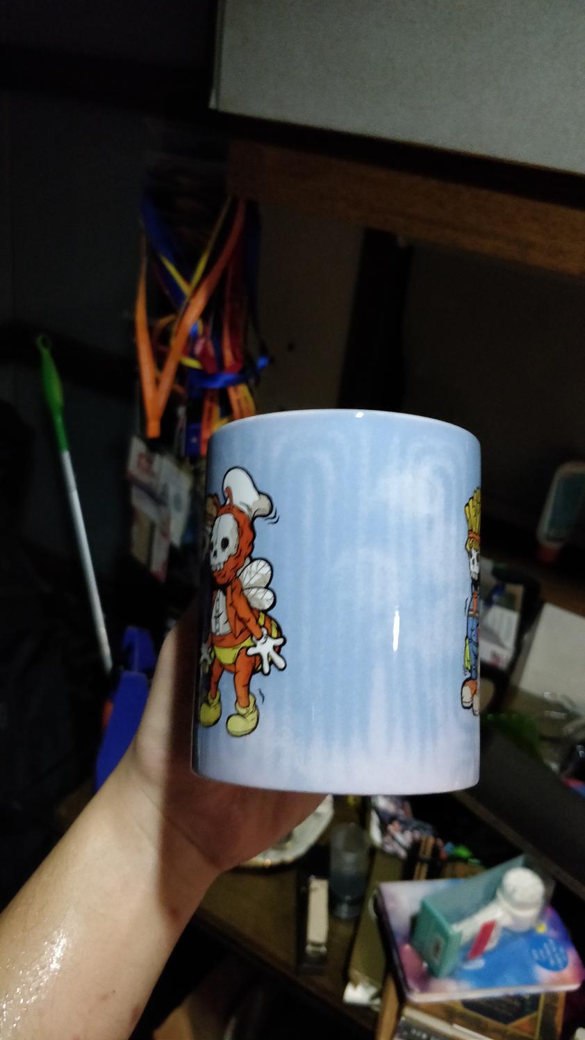

[ATTACH=CONFIG]5907[/ATTACH]
Hi,
I used a mug press and this is my first time doing it. What did I do wrong? There are patterned lines presumably from heated material from the mug press.
Temp: 330
Time: 60 seconds

We would need more information about the press but yes that looks like the heating element. Have you any photos of the press?
Re: Sublimated Mug has lines from heat press
Deffo the heating element. What pressure are you using? I assume that's around 165c? 180c for 180 seconds is a good starting point.
