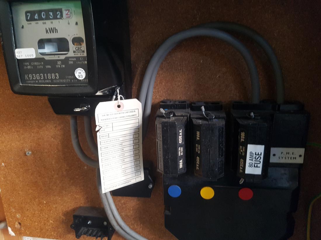

Is this for 3 Phase ...I found this thing in the shop next to the meter ...!!

Yes it's 415 volts 80 amp so it look's like you've got it but you might need more like switches and a fuse bank which your photo doesn't show,I advise you get a local electrician to look at it.

Reg;133660 wrote:Yes it's 415 volts 80 amp so it look's like you've got it but you might need more like switches and a fuse bank which your photo doesn't show,I advise you get a local electrician to look at it.
Wow thats good news thanks ....Ill get a electrician to look at it ..Cheers ..BTW is there a diffence in rates on 3 phase ?..
