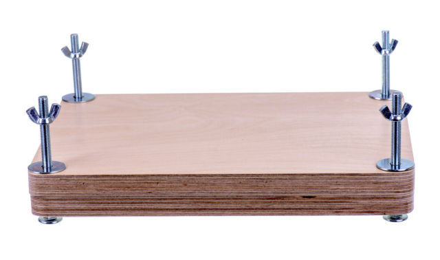

A nipping press would sort out any warping problem.
https://www.ebay.co.uk/p/Book-Binding-P ... 2210057053
