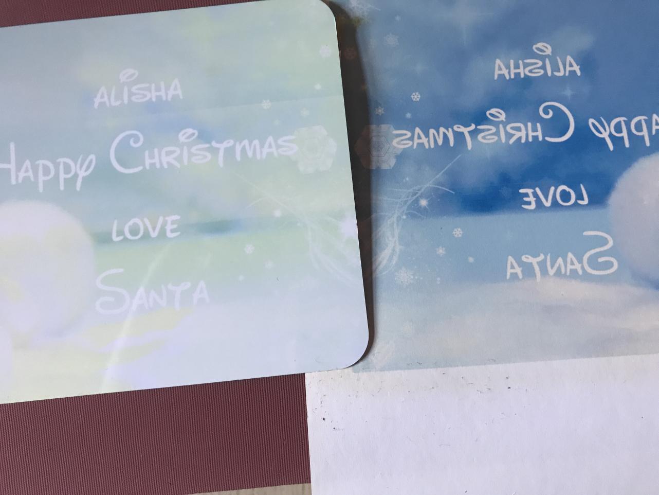

good morning - i go some tins from longeforte "not sure i will again" seems to be allot of ink left on he paper and no ink or not enough on the metal insert, and yellow on parts, not sure if the printer has done a update and kicked everything out on the computer. or if the inks i just have no clue to this one at all
400 f for 60 sec
also tried a mug to see if it was anything and blacks turned out brown so could this be the press?

Hi. Could you be a bit more specific? Which printer, ink, paper combination are you using? What pressure are you pressing at? Is your paper DEFINITELY in the printer the correct way round and not upside down (it happens to the best!)?

Sorry, just read your introductory post. So you have a Ricoh 3110 with compatible inks. I don't see how you can compare printing an insert for a tin with printing a mug though, as they are different presses. If you're getting a brown black on the mug prints then you are either overcooking them (too high a temp or too long) or the inks are rubbish. What are the expiry dates on your inks?
As for the inserts, my first concern would be that you are using the wrong side of the paper if it is leaving nearly all the ink on the paper. If not, then it looks like your press isn't pressing at the correct temp.

I print aluminium sheet, which is basically what you are doing with the inserts for the tins. I lay the print FACE SIDE UP on the press and lay the aluminium sheet FACE SIDE DOWN on top of it, so that the heat transfers through the aluminium. I press with a VERY light pressure, not much more tha just the weight of the top platten on the press really. Your temps and times should be fine if everything else is working ok.

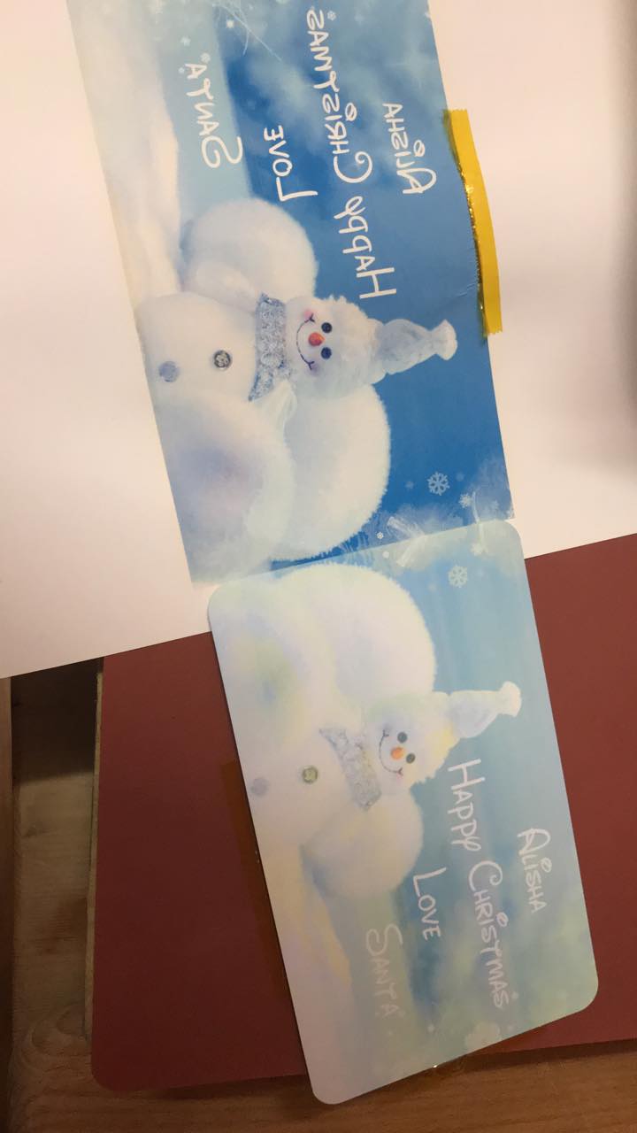

Have just tried with Little pressure still same results

Hi Kraken,
I did something similar to this a few weeks back.
Turns out I had printed on the wrong side of the paper.
I know it sounds silly but if they don't have a backing on them its hard to tell isn't it.
Maybe worth a try over the top of one of the tests you've already done so not to waste your blanks?

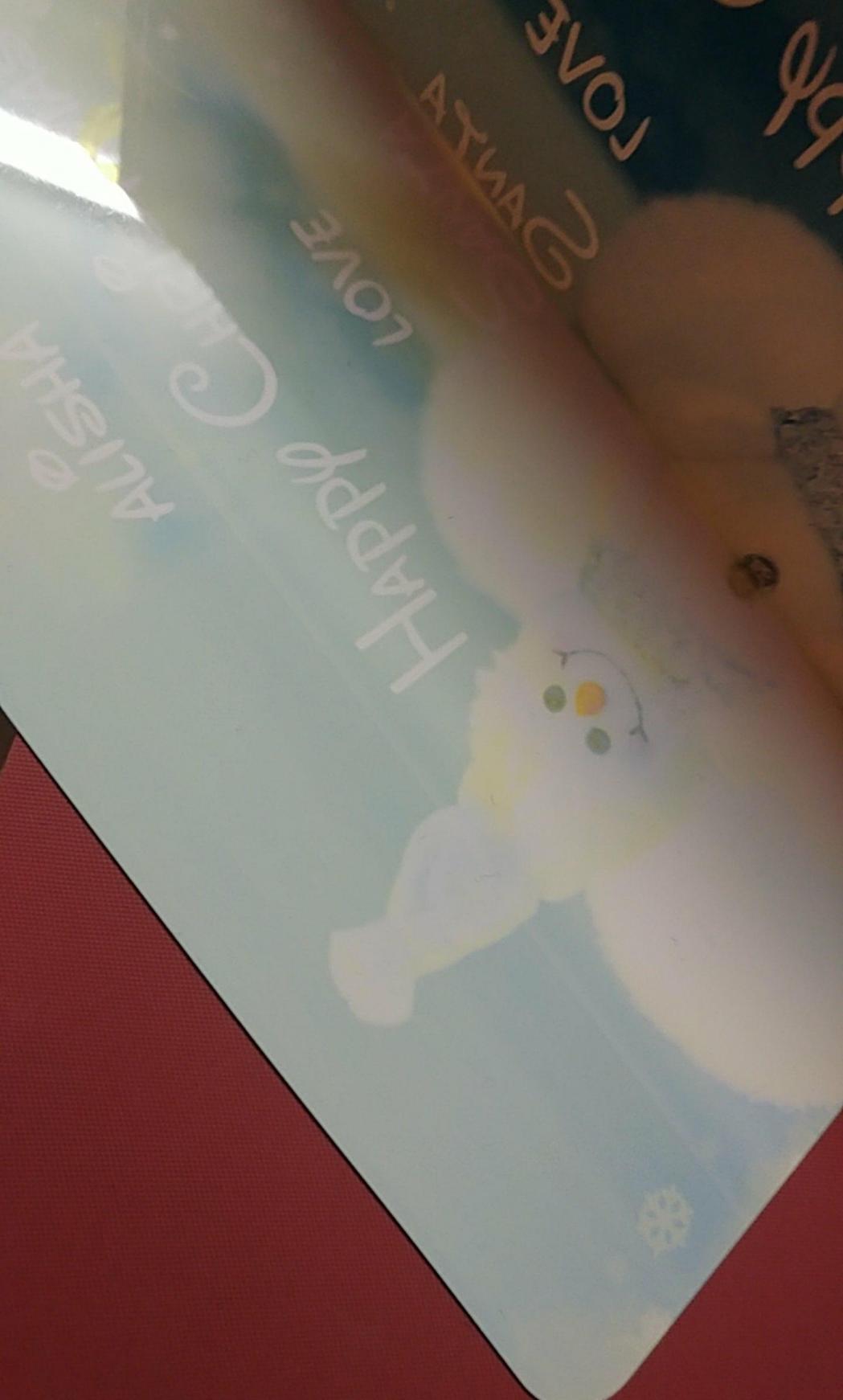

I have done everything I can think of,
Re: tins - Printing nightmare
Have you any other items, a coaster for instance, that you could try pressing to see if it's a problem with the press temperature?
