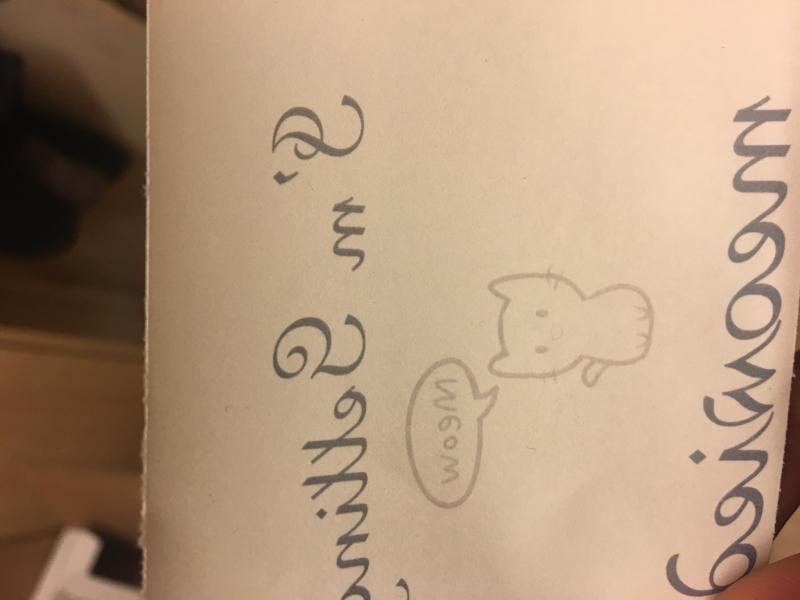

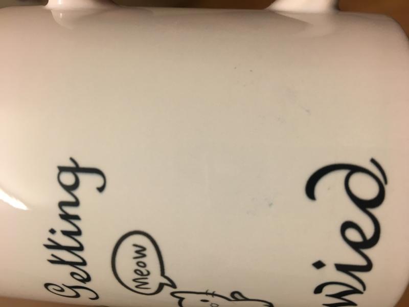

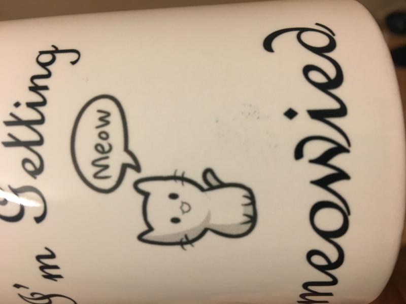

since last couple of days I am getting inks on mugs after sublimation. I didnt change anything like paper, ink, printer or mug press. After printing i am waiting for ink to dry on paper. Any idea you guy suggest me ?

Times and temps won't help, it's finding this ink from somewhere. if the ink isn't visible after printing it sounds like somethings happening during the print process.
I would advise you try a better paper, Trupix for example. Also, I'd be looking at changing those mugs personally. that doesn't help much much for now.
What printer/inkset are you using? Is the additional ink definately not showing on the print? Are you allowing it to dry?

I have had this before, sometimes you just cannot see it on the print. It went after a while, I believe, for me anyway, it was ink that had dropped onto the rollers, and as I said even though I looked at the print couldn't see it.
Are you sure you have the mug clamped up tight to stop any ink leaking along??

Try a head clean, it may be a fine mist that you cannot see on the paper.
