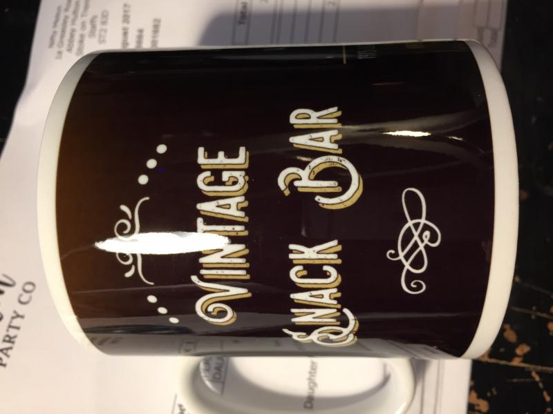

Needed to make this sample for a customer tonight, I have no idea whats gone wrong :(
It's an orca 10oz and I put it in bottom side down...190 for 8 minutes. The black at the top of the cup is faded.
Not sure what I should have done different. Why does it always happen with the things you don't want it too LOL
I don't normally use these mugs so nt sure if ive got the settings wrong or something :(

to me it looks like burned and nor faded.
maybe your timing is to long? or temp to hot.
or both....

Ah, hadn't really considered it was burnt, If anything I thought not long enough - shows how much I know LOL
Re: Mug whoahs :( printing a mostly black image
8 minutes?? What press are you using?

Justin;125654 wrote:8 minutes?? What press are you using?
Its a ST3042 3d heat press. That's the time I was given when I bought it, is that wrong LOL

I use a press from BMS and find 170 degrees for 55 seconds on a pre heated mug is right for my pressings. 8 minutes seems like waaaaaaay too long.
Sorry just googled info on your press and it appears your press is totally different from mine...but I still reckon 8 minutes is way too long.
carolm1a;125655 wrote:Its a ST3042 3d heat press. That's the time I was given when I bought it, is that wrong LOL
Ahh, an oven not a press ;-)

Justin;125657 wrote:Ahh, an oven not a press ;-)
I was reading off the label :)
