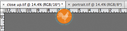

Re: elements 15
In Elements you can only edit images in 8-bit RGB.
Look at the tab of your image and if it says anything other than that then Elements will load the image but won't allow editing.
In this screenshot only the RGB 8-bit image (as seen on the tab) can be edited...
