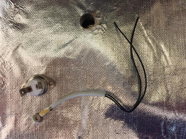

It will probably be your thermometer sensors.
Easy to replace, pain in the neck to get hold of though, normally you have to go to China for spare parts and even then they are not that helpful.

See the image, the sensor is the long thing, but you may as well get a few of the other things as well. Sorry, that is as far as my technical speak goes. Make sure you order for degrees C or F otherwise it plays havoc with your readings
A search on You Tube will show you how to replace these bits.
Lastly, I think you maybe running the machine a bit to high at 200 hence why they have stopped working, you may want to consider a lower temp but longer time.

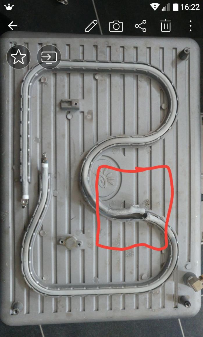

Hi, thanks again for your response, i just took my machine apart and it looks like the element in the bottom base is knackered! ... My guess is you where right in saying 200c is too hot and puts to much stress on the machines components, one thing i noticed is there is no thermometer sensor on the bottom/base element, is this normal? See my picture the bottom/base element has totally bent out of place and ruptured! :(
Gonna have to buy a new machine, a little off topic here but hopefully somebody can help me so i dont have the same issue with the new machine, gonna have to put them in at a lower temp but for longer as you said socialgiraffe. I mostly do mugs/cups and various sized slates, you wouldn't happen to have any idea on a good temp and length of time to put the slates and cups/mugs in?
