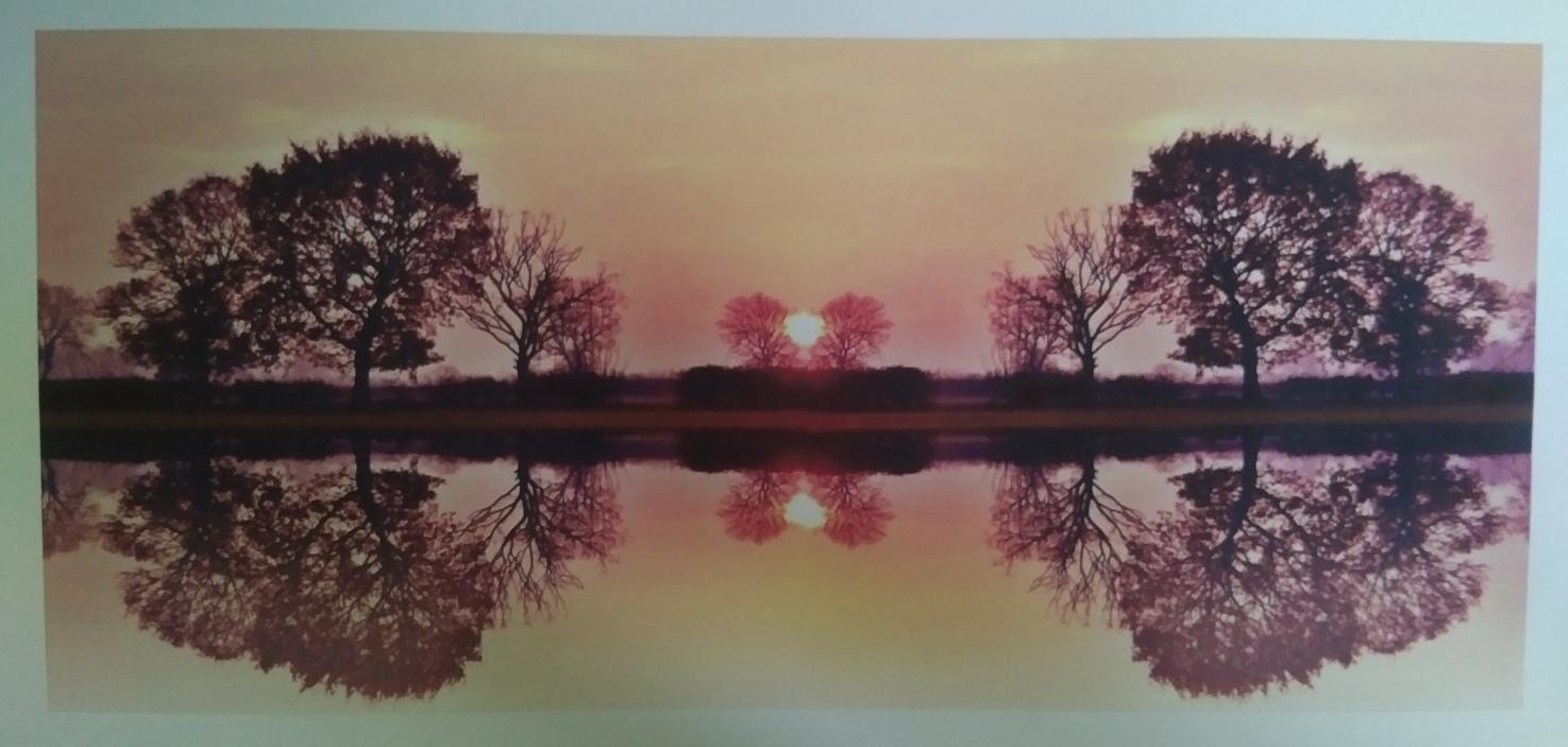

I am very disappointed with the colour I am getting from my printer, very dull, nothing like the colour from my HP inkjet printer. I have done a head clean but still horrible. How can I set up the colours?

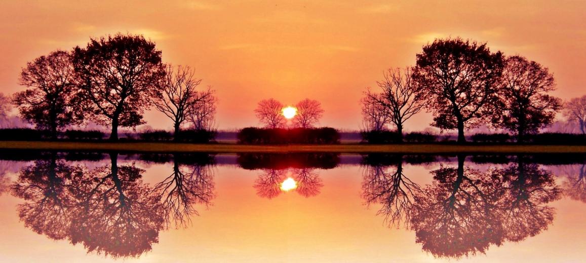

I am using Creative Studio Print & Colour Manager. The image on the computer screen is bright and colourful but when I print it onto TexPrint-R is dull and lacking colour

The righthand image is printed prior to pressing, I am using the paper supplied with the printer. I have done a head clean and all the cartridges have ink.
