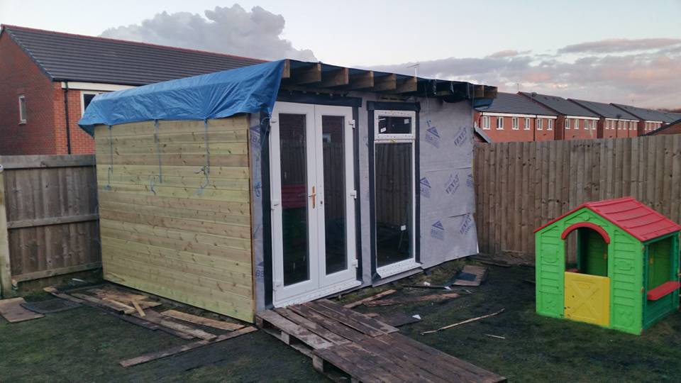

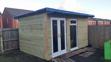

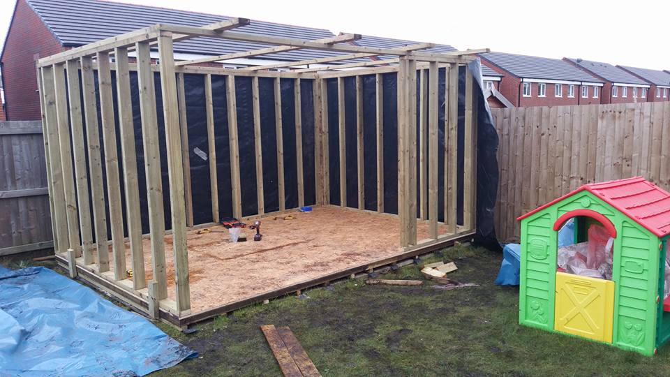

Just thought I would take the time to share some images of my new workshop that I'm currently building. 14' x 10' in case anyone is wondering.

Im looking at doing same what thickness and type of insulation are you using I was looking at 100mm of Kingspan all around

mags1892;110888 wrote:Im looking at doing same what thickness and type of insulation are you using I was looking at 100mm of Kingspan all around
It's 4x2 framing inc the roof with Kingspan insulation panels in the floor & roof. Walls will be rockwool insulation. There will be a permanent seperate feed from the main consumer unit. Did consider using sips panels but opted for the 4x2 framing for ease of feeing the mains & lighting circuts. total cost to date is in the region of £1600.00. Wood and kingspan from a local mill, with the french doors and window costing £65.00 for the 2 on ebay.

Nice, keeps things all out of the way. Just wondering if the other one (Green, red and yellow) is your current workshop........

JMugs;110908 wrote:Nice, keeps things all out of the way. Just wondering if the other one (Green, red and yellow) is your current workshop........
Chuckle, chuckle...
:tongue:
Thats the expresso mugs and keyrings dept.
